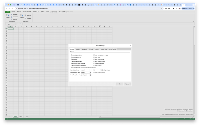

Creating a custom "Spread Setting" pop up selection
Posted by: fcherny on 8 January 2024, 5:26 pm EST

You could update the “SpreadSettingDialog” template to remove the “Allow Auto Create Hyperlink” option. Use the “getTemplate()” method to get the “SpreadSettingDialog” template and “registerTemplate()” method to register the template.
Refer to the following code snippet:
// Get the "SpreadSettingDialogTemplate" let spreadSettingsTemplate = GC.Spread.Sheets.Designer.getTemplate(GC.Spread.Sheets.Designer.TemplateNames.SpreadSettingDialogTemplate); // Remove the option "allowAutoCreateHyperlink" spreadSettingsTemplate.content[0].children[0].children[0].children[0].children[2].children[0].children = spreadSettingsTemplate.content[0].children[0].children[0].children[0].children[2].children[0].children .filter(item => item.bindingPath !== "allowAutoCreateHyperlink"); // Additionally adjust the width of the Column So that there is no overlapping of the text spreadSettingsTemplate.content[0].children[0].children[0].children[0].children[2].children[0].width = "300px"; // Register the "SpreadSettingDialogTemplate" with updated options GC.Spread.Sheets.Designer.registerTemplate(GC.Spread.Sheets.Designer.TemplateNames.SpreadSettingDialogTemplate, spreadSettingsTemplate);
Further, you could set the Spread options using the following code:
// Additionally set the "allowAutoCreateHyperlink" option spread.options.allowAutoCreateHyperlink = false; // Default is true

That did it. Thanks!
