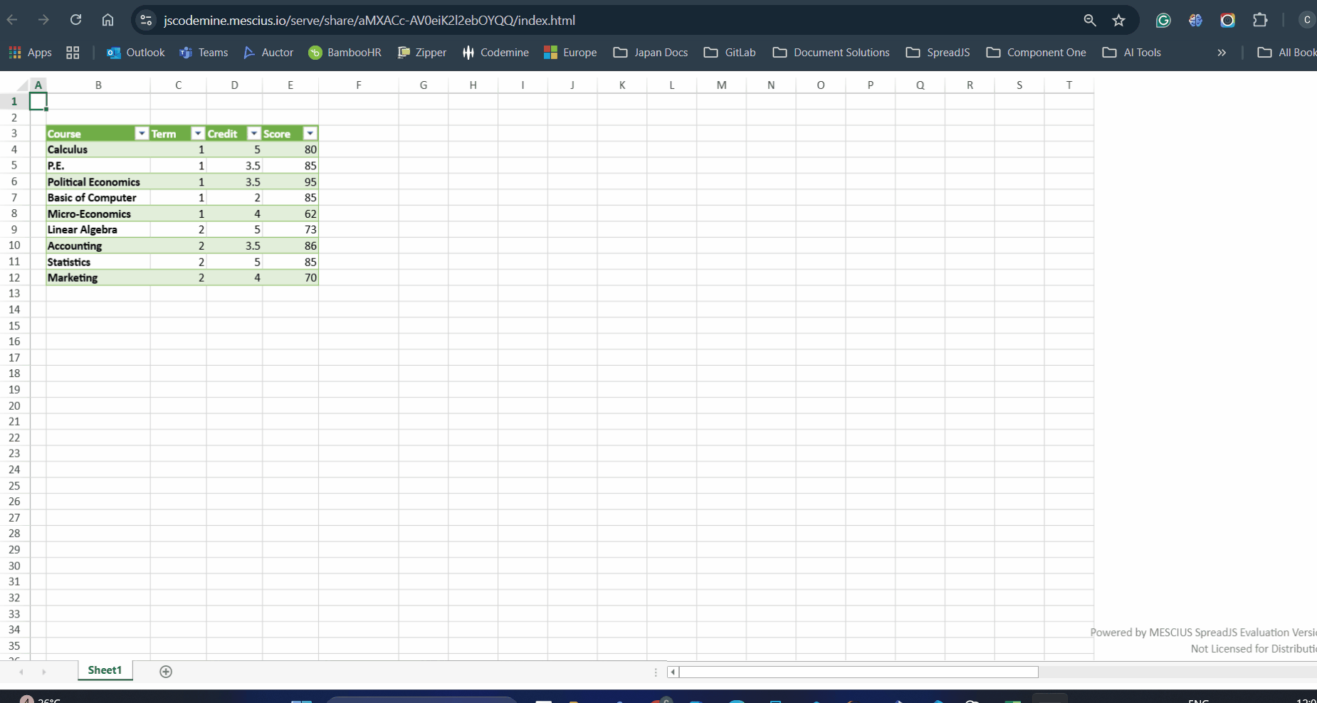

    You may also refer to the attached code sample, which demonstrates the implementation of the above snippet and successfully replicates the desired undo/redo behavior (see below).
    Sample: https://jscodemine.mescius.io/share/aMXACc-AV0eiK2l2ebOYQQ/?defaultOpen={"OpenedFileName"%3A["%2Findex.html"%2C"%2Fapp.js"]%2C"ActiveFile"%3A"%2Fapp.js"}
    GIF:
    Please feel free to reach out if you require any additional assistance.
