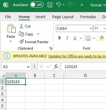

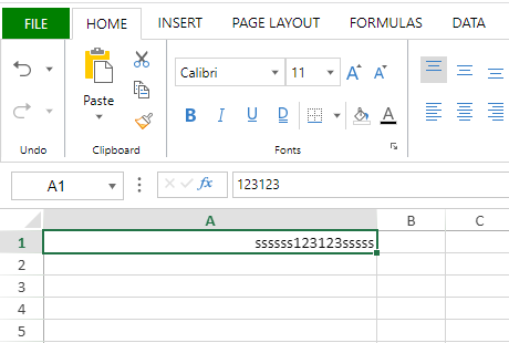

    The value is displayed as: ssssss123123sssss (as you can see in attached img1)
    If you’ll do the same in Excel the value will display as: 123123 (as you can see in attached img2)

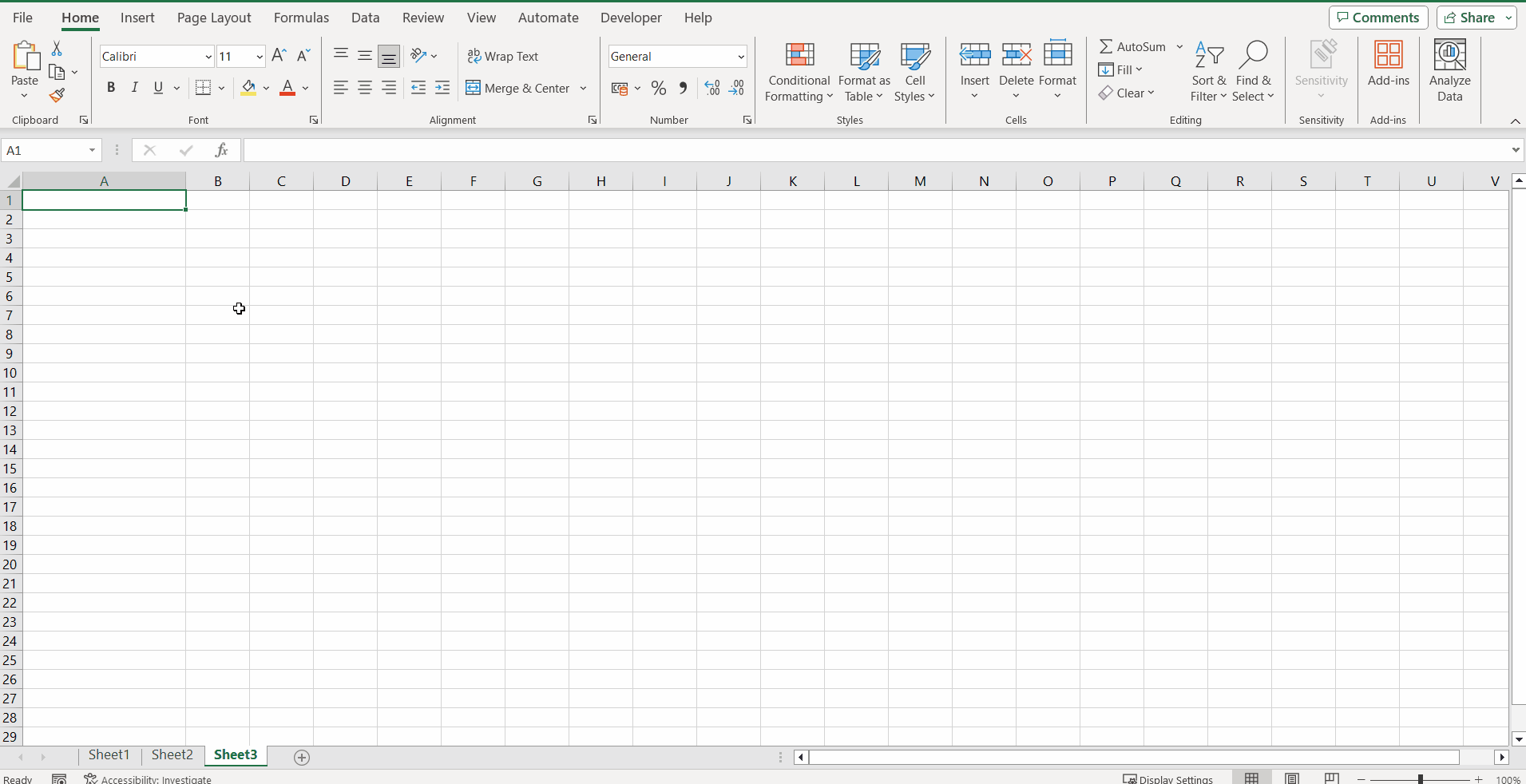

    We are not able to replicate the issue on our end in case of format string “ssssss”@“sssss”. In MS Excel, applying format string formats the value to “ssssss123123sssss” which is the same as SpreadJS. Please refer to the attached gif(demo.gif) and note that MS Excel doesn’t update cell immediately. You need to enter in edit mode of cell and then exit to see the changes.
    In the case of the format string “00@”, we are able to replicate the issue on our end. Hence, we have escalated it to the dev team for further investigation. The internal tracking ID for the issue is: SJS-20908. Please be rest assured that we will keep you updated on the progress of the issue.
