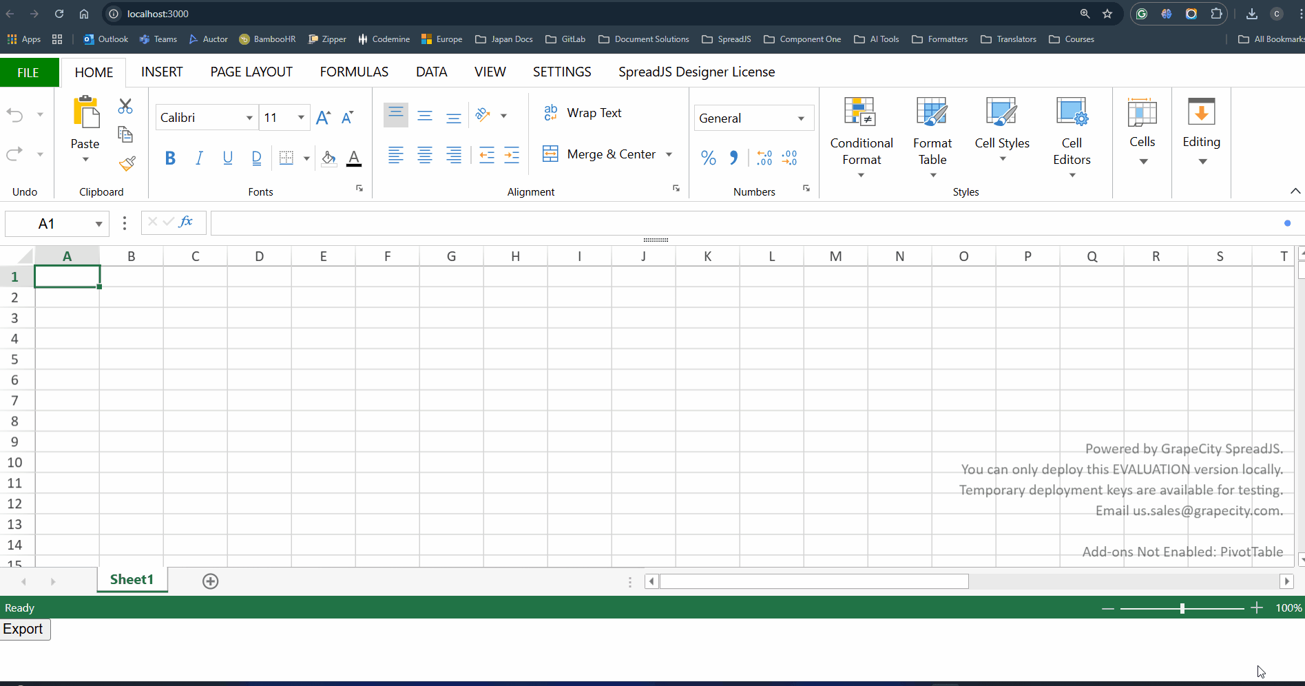

    To generate an XLSX file export containing the standard formulas and results of custom formulas without the actual formulas, it is required to pre-process the SpreadJS Workbook to strip off the custom formulas. Please refer to the attached sample that implements a custom logic to achieve the same (see below).
    Please feel free to reach out if you encounter any further issues or require additional guidance.
    Sample: customValues.zip
    Steps to run the sample:
    • Open the folder in the terminal and write the command - npm i to install project dependencies.
    • Run the command - npm run start to start the application.
    Gif:
