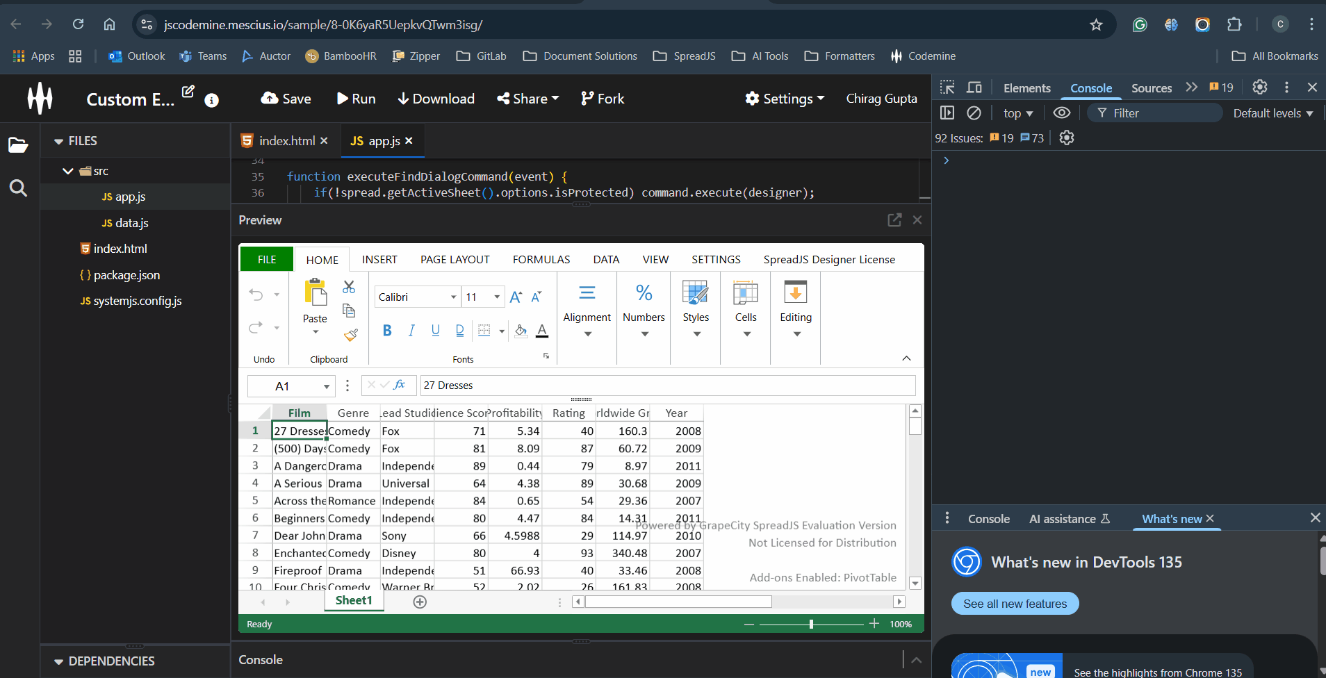

    It is possible to control the Find and Replace Dialog pop-up based on the sheet protection. Please refer to the attached sample that illustrates the same (see below).
    Additionally, could you please explain how you are using the “Clear” from the context menu on a protected sheet? On our end, the option is disabled. Please refer to the attached recording.
    Sample: https://jscodemine.mescius.io/share/QNLHU1KIpUyWc22j8jgKow/?defaultOpen={"OpenedFileName"%3A["%2Findex.html"%2C"%2Fsrc%2Fapp.js"]%2C"ActiveFile"%3A"%2Fsrc%2Fapp.js"}

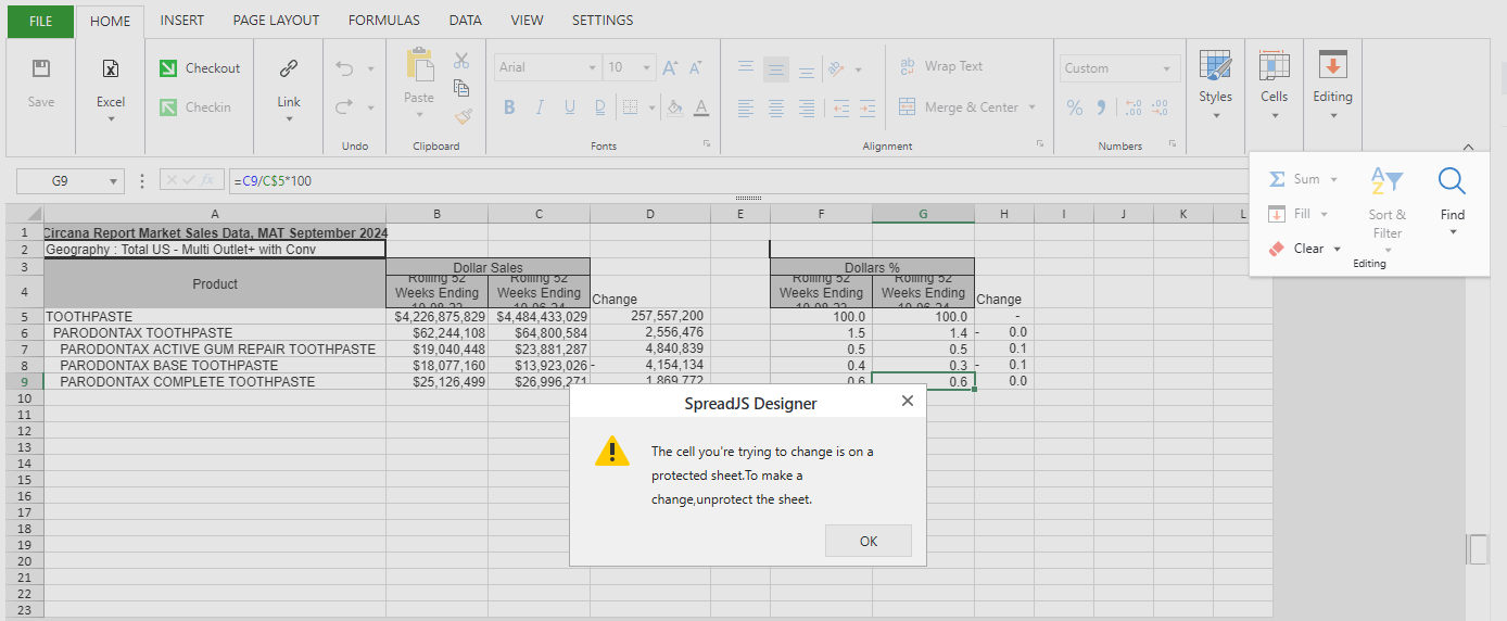

  • Posted 16 April 2025, 8:12 am EST - Updated 16 April 2025, 8:17 am EST
    See attached screnshot which shows the clear option I clicked and the error i am seeing , hopefully this helps

    Thanks for sharing the additional details. We can replicate the behavior you mentioned on our end. However, the error message displayed while performing a clear operation from the Editing menu can be customized by customizing the designer resources. Please refer to the code snippet below that illustrates the same:
    let customProtectionErrorMessage = "Custom Message!!";
    var resources = GC.Spread.Sheets.Designer.getResources();
    resources["protectionOptionDialog"]["errorMessage"] = customProtectionErrorMessage;
    GC.Spread.Sheets.Designer.setResources(resources);
    Additionally, it is possible to display only the Find dialog when the sheet is protected and the Find & Replace dialog when it is in an unprotected state. Please refer to the code snippet below that illustrates the same:
    const findDialogCommand = GC.Spread.Sheets.Designer.getCommand(GC.Spread.Sheets.Designer.CommandNames.FindDialogFind);
    var findDialogTemplate = GC.Spread.Sheets.Designer.getTemplate(GC.Spread.Sheets.Designer.TemplateNames.FindDialogTemplate);
    const onlyFindTemplate = {
      ...findDialogTemplate,
      content: [...findDialogTemplate.content],
      buttons: [...findDialogTemplate.buttons],
    onlyFindTemplate.content[0] = {
      ...findDialogTemplate.content[0],
      children: [...findDialogTemplate.content[0].children],
    onlyFindTemplate.content[0].children.splice(1, 1);
    onlyFindTemplate.buttons.splice(0, 2);
    onlyFindTemplate.title = "Find";
    function executeFindDialogCommand() {
        if(spread.getActiveSheet().options.isProtected) {
          GC.Spread.Sheets.Designer.registerTemplate(GC.Spread.Sheets.Designer.TemplateNames.FindDialogTemplate, onlyFindTemplate);
        else {
          GC.Spread.Sheets.Designer.registerTemplate(GC.Spread.Sheets.Designer.TemplateNames.FindDialogTemplate, findDialogTemplate);
        findDialogCommand.execute(designer);
    document.addEventListener("keydown", function (event) {
      if (event.ctrlKey && event.key.toLowerCase() === "f") {
        event.preventDefault();
        executeFindDialogCommand();

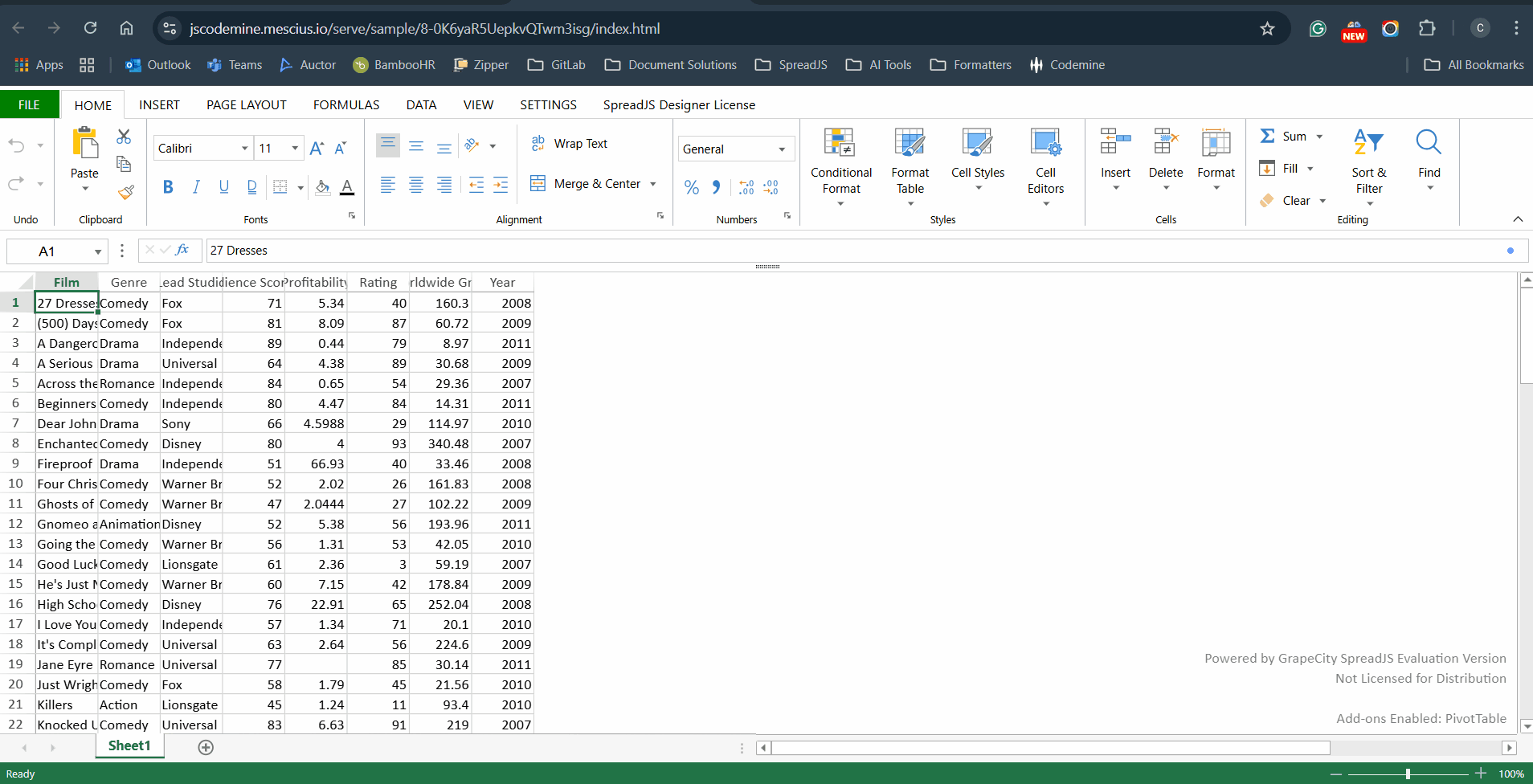

    You can further refer to the attached sample: https://jscodemine.mescius.io/share/QNLHU1KIpUyWc22j8jgKow/?defaultOpen={"OpenedFileName"%3A["%2Findex.html"%2C"%2Fsrc%2Fdata.js"%2C"%2Fsrc%2Fapp.js"]%2C"ActiveFile"%3A"%2Fsrc%2Fapp.js"}, which uses the above code snippets and achieves the required results (see below).
    GIF:
    Please feel free to reach out if you require additional guidance.
