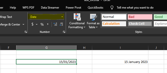

    I have an Excel file with some cells formatted “dd/mm/yyyy” with the locale is en-GB
    when I open that file on my app with the locale I defined above, the locale display is correct
    but when I input the new value in the other cell (15/01/2023), it does not get the correct date format
    Can you point out my mistake in the definition above?

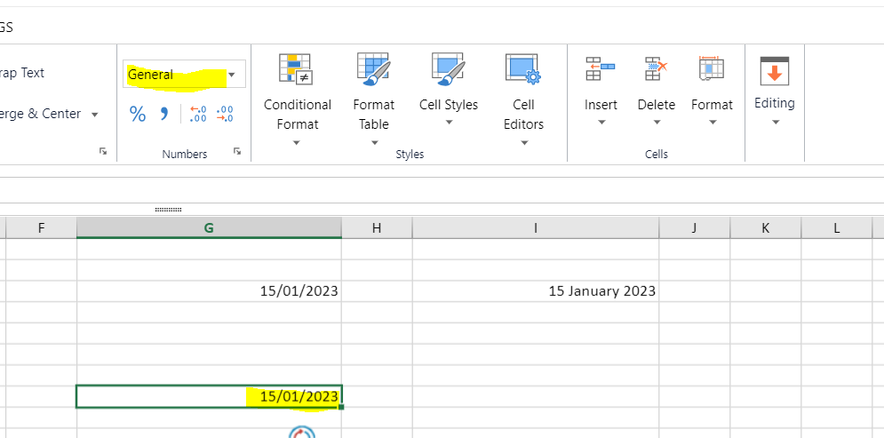

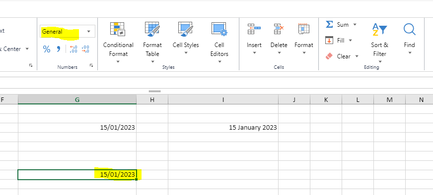

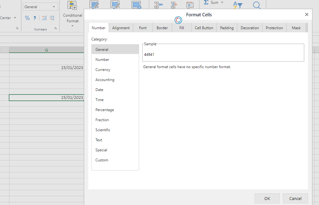

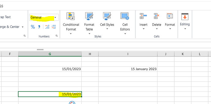

    Hi Avinash,
    When I asked this question, I used that method before but this issue still occurs. As shown in the picture below, I entered the value “15/01/2023” but it shows the type as a general while the date format has been defined and the locale has been set correctly
    Please help me double-check it. Many thanks.

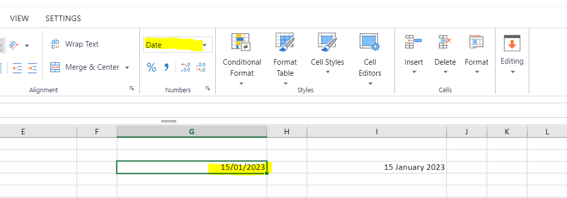

  • Posted 21 December 2023, 8:02 am EST - Updated 21 December 2023, 8:07 am EST
    We have tested the latest version and on our end, it works fine instead of the date it shows custom which is expected as told spreadJS about the file locale and provided our local custom format. Please refer to the following sample and if the issue persists please share a working sample that replicates the issue so that we can investigate it further and help you accordingly.

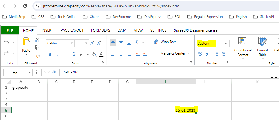

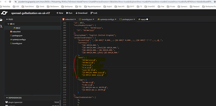

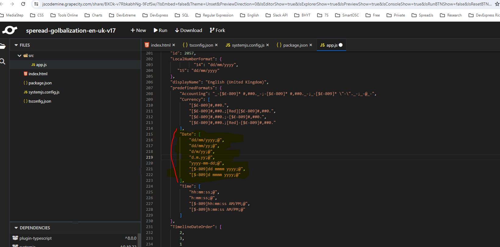

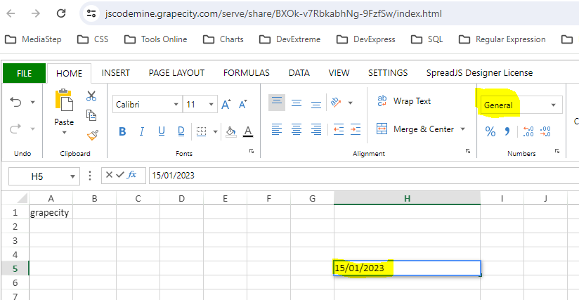

  • Posted 22 December 2023, 3:41 am EST - Updated 22 December 2023, 3:47 am EST
    Hi Avinash,
    I have tested in the link you provided above, even though the en-uk locale option has been set, but when I enter the value “15/01/2023” into the empty cell, it auto converts to the value “15-01-2023” with the custom type, is not date type, even though the date format is defined in the predefinedFormats

  • Posted 27 December 2023, 12:31 am EST

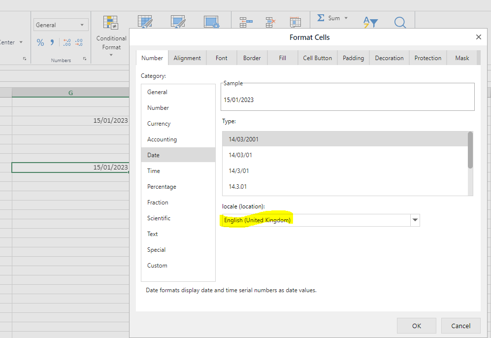

    The reason why it shows “15-01-2023” is because the date separator was set to “-” . You could set the date formatter to “/” and it will show the value “15/01/2023” when you enter “15/01/2023”.
    Yes, I agree that we have defined the formatter “dd/mm/yyyy” in the predefinedFormats (Date) , still SpreadJS Format Dialog shows the format as “Custom”. For this, I have escalated the case to the concerned dev team for further investigation. The internal tracking id for the same is: SJS-22078 and I will let you know when I have an update from the dev team.
    Ankit

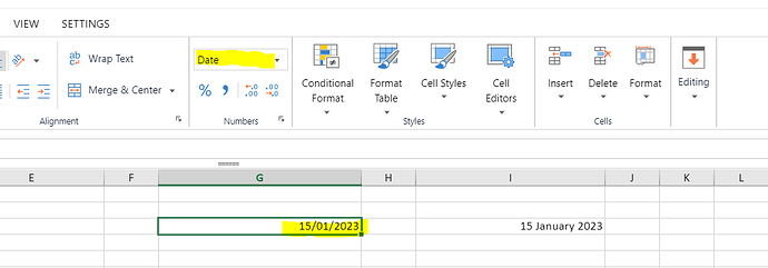

  • Posted 11 January 2024, 7:57 am EST
    The devs have mentioned that you need to set the ShortDate format in the resources. Kindly refer to the following code snippet:
    // Get the Resources
    let res = GC.Spread.Sheets.Designer.getResources();
    res.commonFormats.ShortDate.format = "dd/mm/yyyy";
    // Set the Resources
    GC.Spread.Sheets.Designer.setResources(res);
    In Microsoft Excel, when you enter a date value as a cell, a date formatter will be applied to the cell directly.
    And SpreadJS, as a component, we don’t pollute the user’s data (the cell style is kind of user data).
    If you want the “Format Dialog” to show the category as Date, you could monitor the CellChanged, set the autoFormatter to the cell formatter. If you want the “Format Dialog” to show the category as Date, use the following code snippet:
    spread.bind(GC.Spread.Sheets.Events.CellChanged, function (evt, args) {
        if (args.propertyName === '[styleinfo]' && !args.oldValue && args.newValue && args.newValue._autoFormatter) {
            var { sheet, row, col } = args;
            var style = sheet.getStyle(row, col);
            style.formatter = style._autoFormatter;
            sheet.setStyle(row, col, style);
    Sample: https://jscodemine.grapecity.com/share/1a2aExkwXkKQduPx3l37Ug/?IsEmbed=false&Theme=Unset&PreviewDirection=0&IsEditorShow=true&IsExplorerShow=true&IsPreviewShow=true&IsConsoleShow=true&IsRunBTNShow=false&IsResetBTNShow=false&IsOpenInCodemineBTNShow=false&PanelWidth=20&PanelWidth=50&PanelWidth=30&defaultOpen={"OpenedFileName"%3A["%2Fsrc%2Fapp.js"]%2C"ActiveFile"%3A"%2Fsrc%2Fapp.js"}
