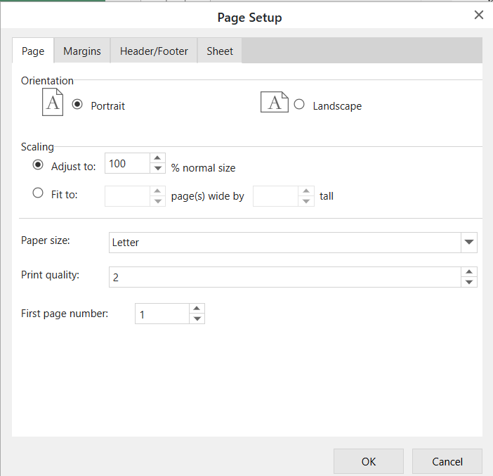

    I want to remove the scaling portion of the page setup pop up but I cant find any documentation providing a way to do that. Is there a template or something I could edit to remove the elements I dont want anymore. I want to remove the “fit to” options in the scaling.

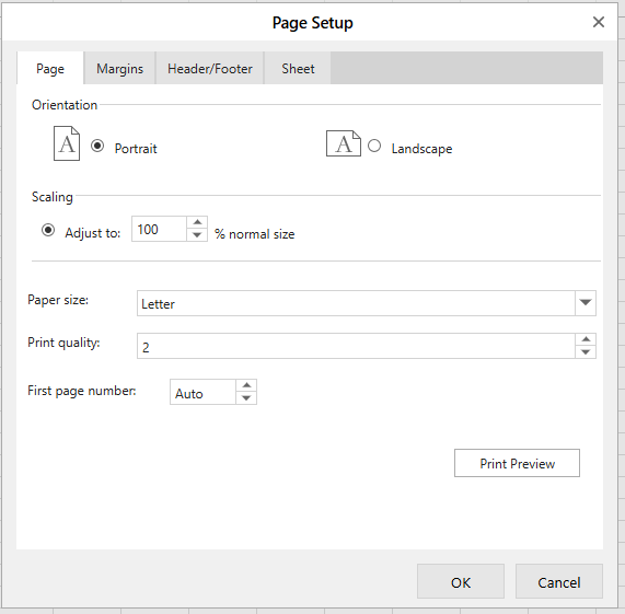

    Yes, the Page Setup dialog in SpreadJS Designer corresponds to the “GC.Spread.Sheets.Designer.TemplateNames.PageSetupDialogTemplate” template. You can customize this template to remove any undesired sections from the dialog.
    Please find below a sample code snippet demonstrating how to remove the “Fit to” option from the Page Setup dialog:
    var pageSetupDialogTemplate = GC.Spread.Sheets.Designer.getTemplate(GC.Spread.Sheets.Designer.TemplateNames.PageSetupDialogTemplate);
    var fitTo = pageSetupDialogTemplate.content[0].children[0].children[3].children[0].children[0].items;
    // Find the index of the "Fit to" item
    var fitToIndex = fitTo.findIndex(item => item.text === "Fit to:");
    // If the item is found, remove it
    if (fitToIndex !== -1) {
        fitTo.splice(fitToIndex, 1);
    // removing the setting portion associated with fit to:
    var fitToSetting = pageSetupDialogTemplate.content[0].children[0].children[3].children[1].children[1] = {};
    //registering the updated Template back
    GC.Spread.Sheets.Designer.registerTemplate(GC.Spread.Sheets.Designer.TemplateNames.PageSetupDialogTemplate, pageSetupDialogTemplate)

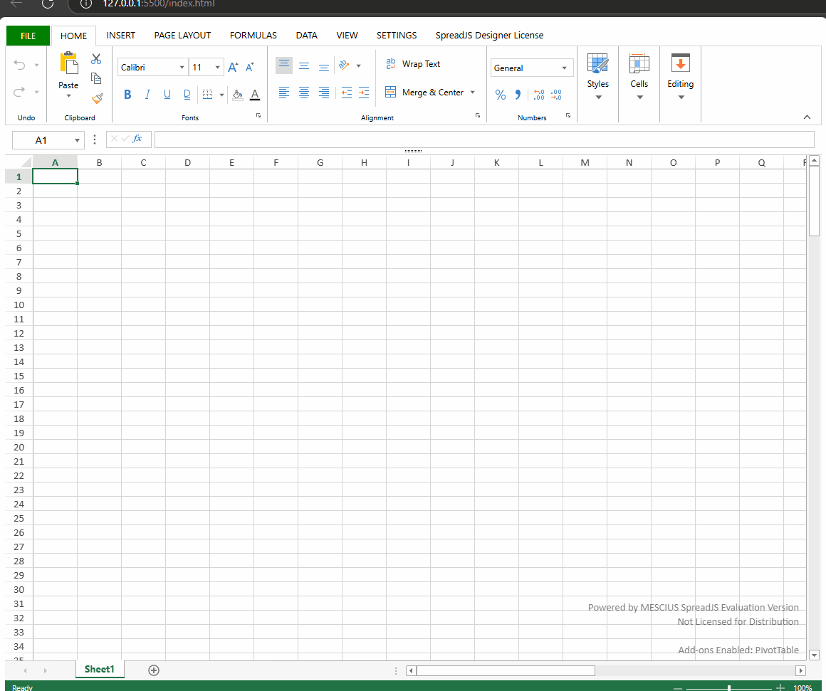

    Expected Ouput:
