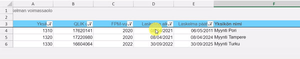

We are using the spreadjs v15 in angular application and facing the date input issue in spreadsheet. Whenever I enter the date in the format - mm/dd/yyy, upon clicking anywhere outside of that specific cell, it changes to the format - dd/mm/yyyy (cells D4 and D5).
But when I enter the date in the format - dd/mm/yyyy (as shown in the video in cell D6), the date stays the same and gives error upon saving as now it is considering 30 as month and that does not exist.
Spreadsheet is expecting the date in the format mm/dd/yyyy and later changes to another format. I have tried to change my system date format to mm/dd/yyy but it is still behaving the same.
I would like to enter the date in the format - dd/mm/yyyy and that it stays the same and would like to know if this something related to spread and is there any fix available?
Note - it is behaving the same way upon copy pasting the date.
