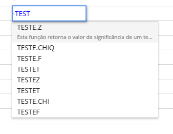

    Hello erveryone,
    I’m trying to insert a value into a cell, but the value starts with “-”, so the formula modal opens
    But I need that value to be a text
    Example

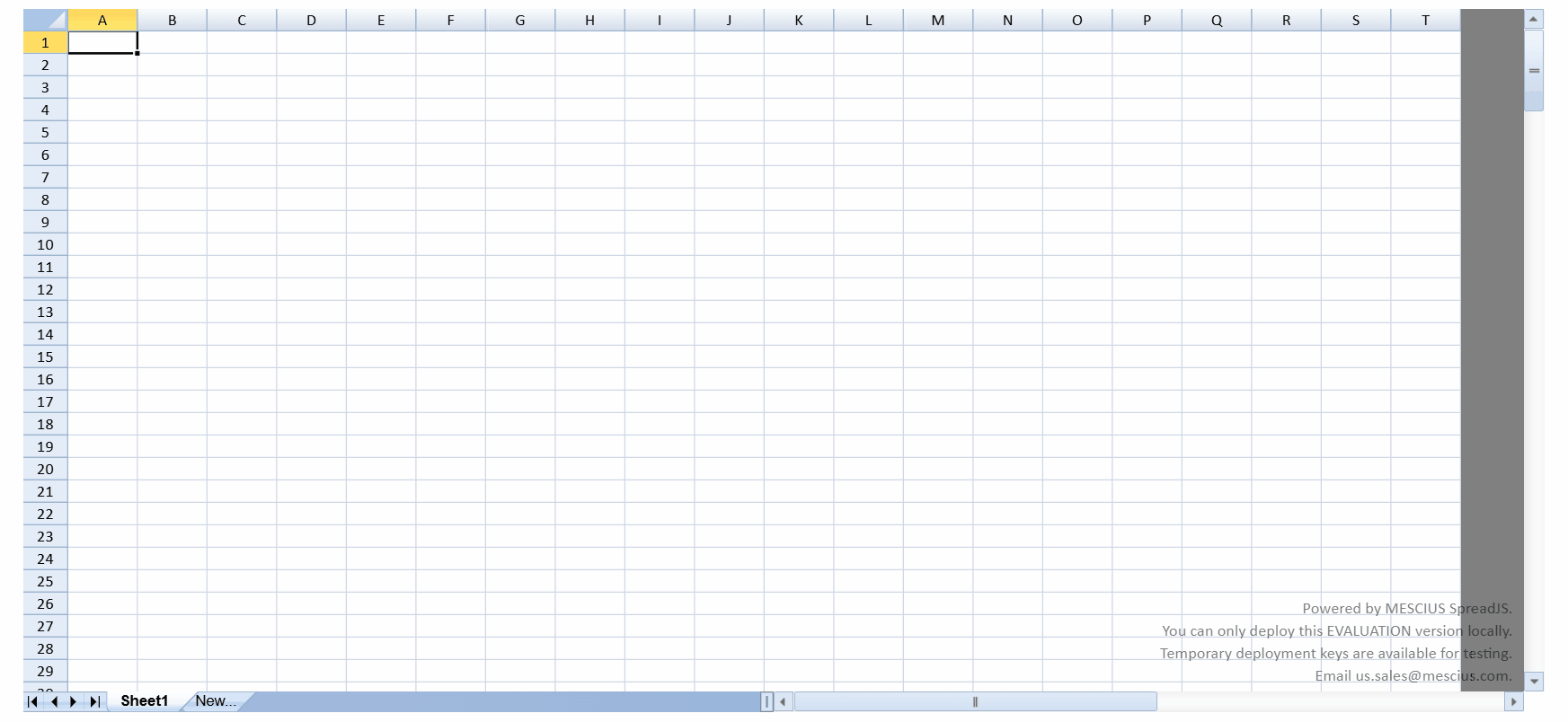

    You can further refer to the attached sample that uses the above code snippet and handles the values starting with - (see below).
    Ankit
    Minus.zip
