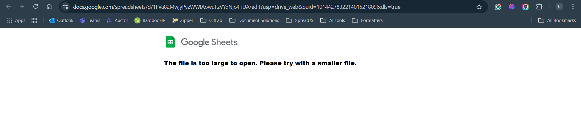

    We have tried to load the file Google Sheets, however it fails on that platform too. Please refer to the following screenshot:

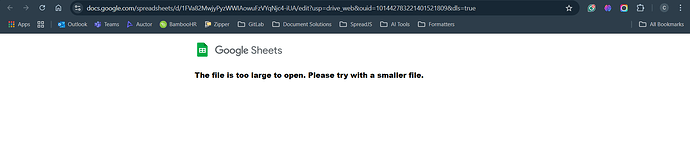

    I attempted to load the attached file in both Online Excel and Google Sheets but was unsuccessful due to the file’s large size.

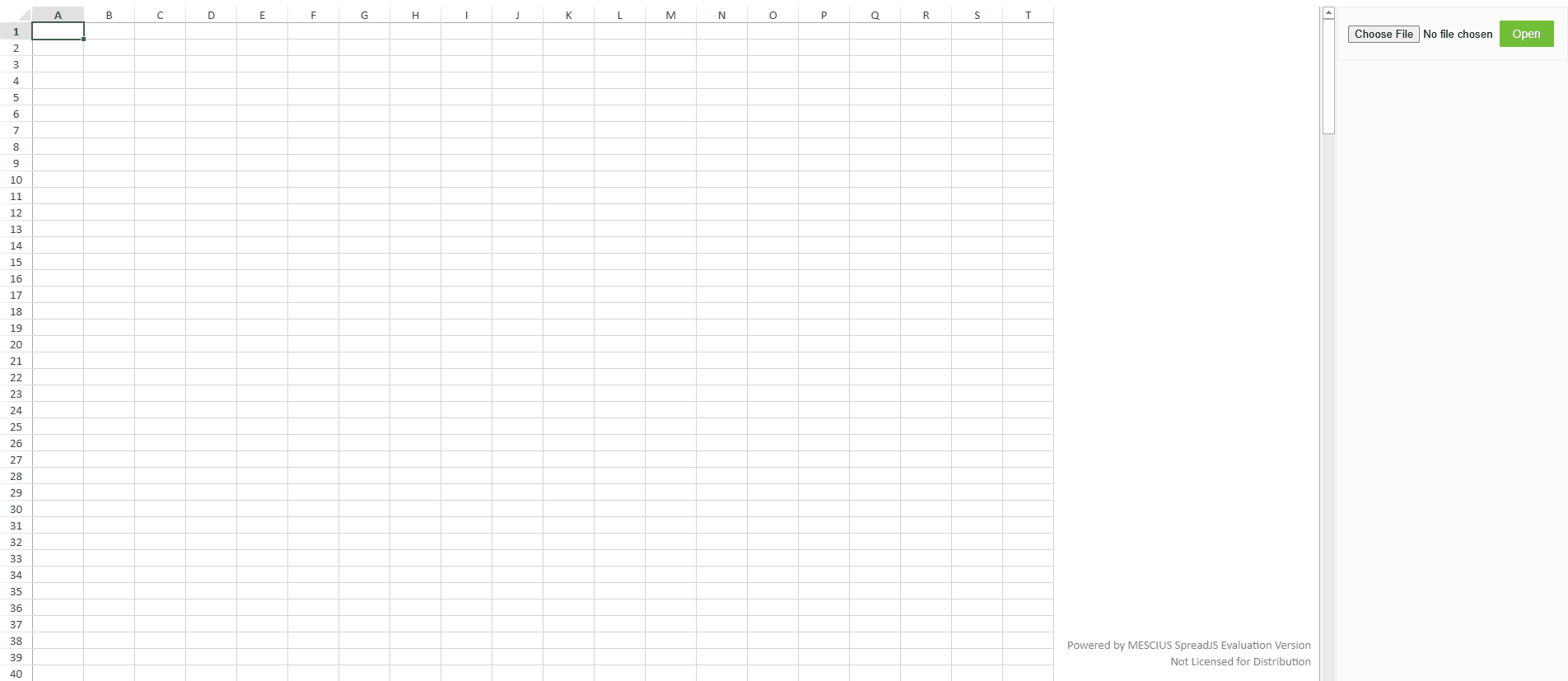

    When trying to load and read the blob’s text using native APIs, nothing is returned for large files. As shown in the attached GIF : , SpreadJS assumes the file is either in an incorrect format or is corrupted when the blob text cannot be read. SpreadJS does not impose a file size limit for importing files, which is why no “File is too big” error is thrown.
