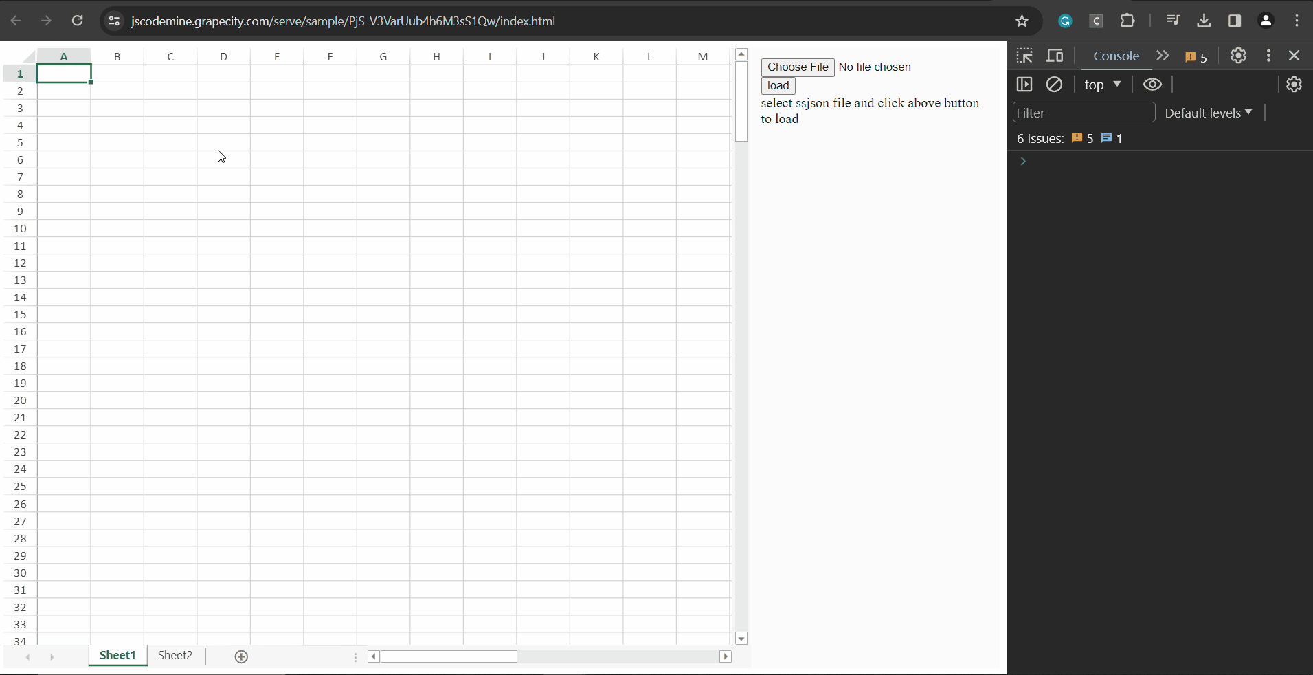

    We are not able to replicate the issue at our end. We tried to replicate the issue with SpreadJS v16.2.6 by setting Italian culture to SpreadJS. However, it was working correctly and the formulas were not throwing errors.
    Please refer to the attached sample and GIF for more understanding.
    sample: https://jscodemine.grapecity.com/share/vzJmWVnWyEGkKLXVZZ-dXw/?IsEmbed=false&Theme=Unset&PreviewDirection=0&IsEditorShow=true&IsExplorerShow=true&IsPreviewShow=true&IsConsoleShow=true&IsRunBTNShow=false&IsResetBTNShow=false&IsOpenInCodemineBTNShow=false&PanelWidth=20&PanelWidth=50&PanelWidth=30&defaultOpen={"OpenedFileName"%3A["%2Findex.html"%2C"%2Fsrc%2Fapp.js"%2C"%2Fsrc%2Fculture.js"]%2C"ActiveFile"%3A"%2Fsrc%2Fculture.js"}
    It is crucial to note that the Italian culture should be set in SpreadJS where you are importing the SSJSON file because the parsing and calculation of formulas also depend upon the culture applied.

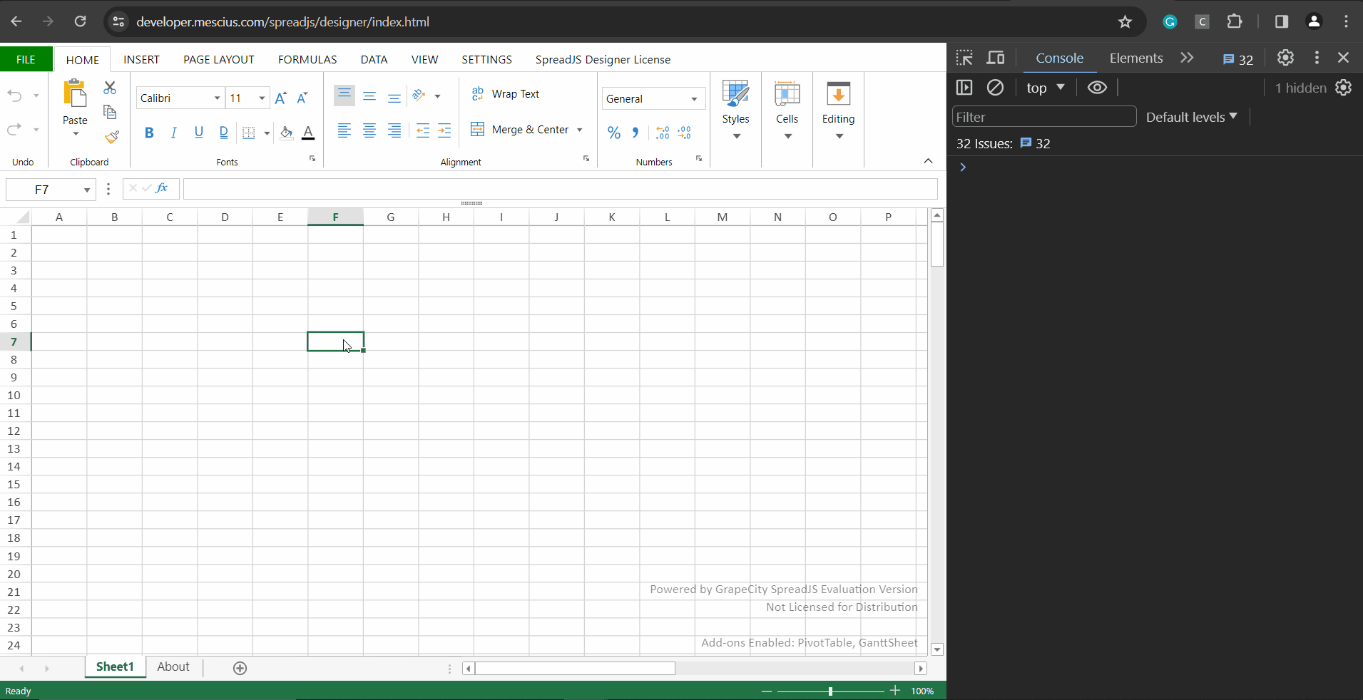

    I have tested it in the SpreadJS Designer at https://developer.mescius.com/spreadjs/designer/index.html. The issue occurs here because the hosted SpreadJS Designer has an en-US culture by default and the SSJSON file includes formats of Italian culture. That is why the issue occurs.
    As I mentioned in my previous reply, the parsing of the values/formulas also depends on the culture applied. A valid formatted value in Italian culture can be invalid in en-US culture.

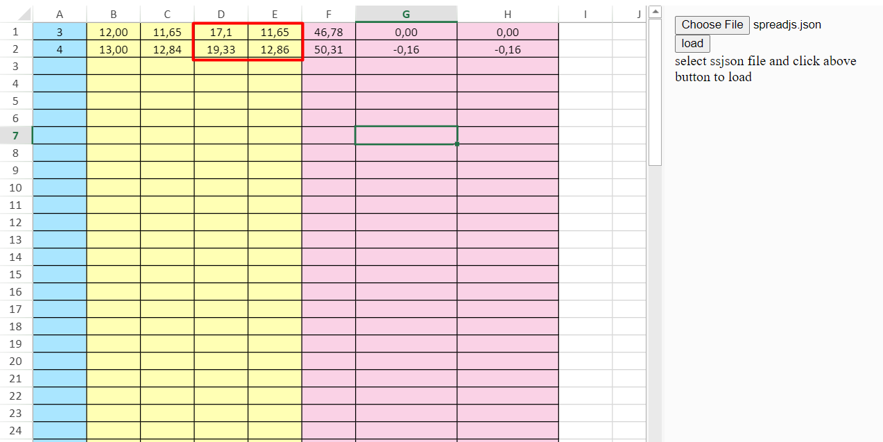

    In the SSJSON file that you have shared with us, the cell range D1:E2 has string values. For instance, cell D1 has the value “17,1”. So, if the Italian(it-IT) culture is applied to SpreadJS and since “,” acts as a decimal separator, the value “17,1” is parsed as 17.1 for calculation in the formulas. That is why, the formulas are calculated without any errors in the SpreadJS sample that I previously shared with you.

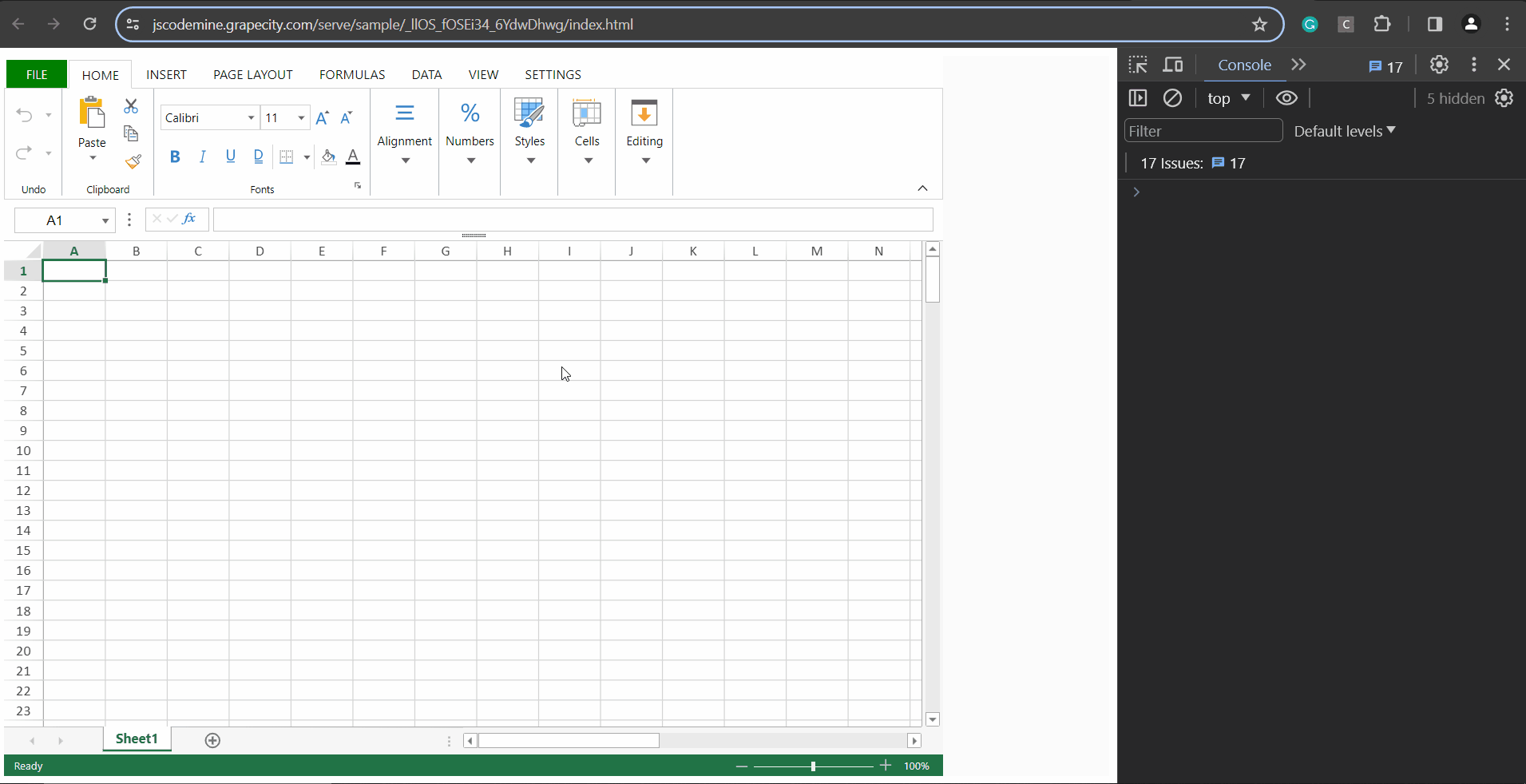

    Kindly refer to the below GIF.
    But when the SSJSON file is imported in the SpreadJS Designer hosted at https://developer.mescius.com/spreadjs/designer/index.html, the formulas are not calculated and #VALUE! errors are thrown because the default culture applied is en-US. In en-US culture, the symbol comma(“,”) is treated as a thousand group separator and not as a decimal number separator. That is why, the string values in cell range D1:E2 can not be parsed to number(data type), and the error is thrown.
    There are two ways to solve the issue. One way is to apply the Italian culture. But since it is already hosted, that is not recommended. However, if you are using SpreadJS Designer in your application, you can apply the Italian culture. Another way is to set number values in cell range D1:E2 instead of string values. So that they could be used without parsing the string values to numbers in the absence of Italian culture.
    It is important to note that the actual values should be set with SpreadJS APIs irrespective of the culture applied. For instance, even if Italian culture is applied to SpreadJS, with SpreadJS APIs the actual value should be set.
    sheet.setValue(0, 0, 11.11); instead of sheet.setValue(0, 0, ‘11,11’);
    In the attached gif, period(“.”) is used as a number decimal separator.

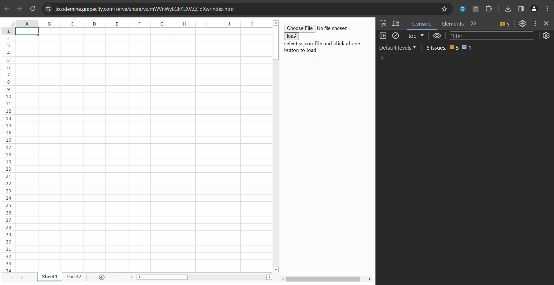

    We are able to replicate the issue at our end. The issue was replicable when Italian culture was applied to SpreadJS and SSJSON file was imported with SpreadJS Designer. Hence, we have escalated this issue to the dev team for further investigation. The internal tracking ID for the issue is SJS-21596. Please be rest assured that we will keep you updated on the progress of the issue.
    As a workaround, you can add an event listener to the FileLoaded event of the designer and inside the handler change the selection on the sheet and use spread.calculate() method to re-calculate the formulas.
    sample: https://jscodemine.grapecity.com/share/B_7Ii-FZjE274cR8LQwueQ/?IsEmbed=false&Theme=Unset&PreviewDirection=0&IsEditorShow=true&IsExplorerShow=true&IsPreviewShow=true&IsConsoleShow=true&IsRunBTNShow=false&IsResetBTNShow=false&IsOpenInCodemineBTNShow=false&PanelWidth=20&PanelWidth=50&PanelWidth=30&defaultOpen={"OpenedFileName"%3A["%2Findex.html"%2C"%2Fsrc%2Fapp.js"]%2C"ActiveFile"%3A"%2Fsrc%2Fapp.js"}
