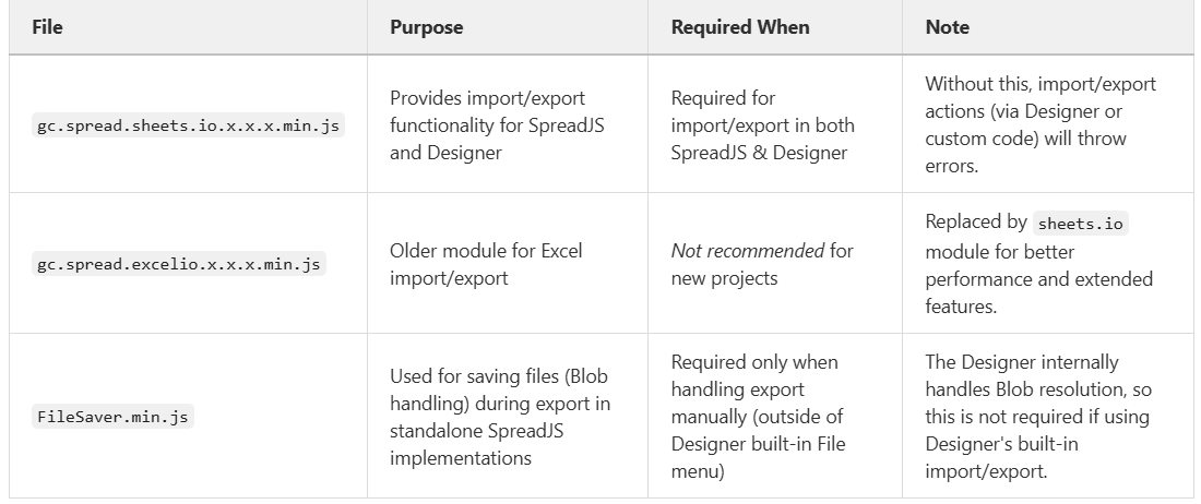

    Hi George,
    Thank you for your detailed query.
    1. Regarding your first question, not all three of these files are strictly required, but here is a breakdown of when and why you would need them:
    1. Regarding your second point, the observed behavior is expected.
    When using the Designer’s built-in File menu (for import/export), Blob handling (for file generation and saving) is already managed internally — so FileSaver.min.js is not required.
    However, if you are manually implementing your own export functionality (outside of the Designer’s built-in UI), then you would need FileSaver.min.js to handle saving the generated Blob as a downloadable file — otherwise, you will encounter the error you mentioned.
    It is recommended that you use the SJSIO over ExcelIO as the new features will be available to the new SJSIO only.
    I hope this clarifies your questions. Please feel free to reach out if you need any further assistance.
