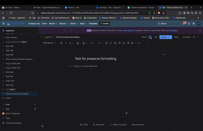

    Steps to produce
    Created a table with branded row or some formatting applied like background color etc
    Paste in Confluence “comment” or Jira Comment or Confluence edit mode or the Gmail create email.
    Repeat the same steps with google sheets.
    The background foreground color and other formatting is not preserved , but when I paste the same data in google sheet it has the formatting preserved.
