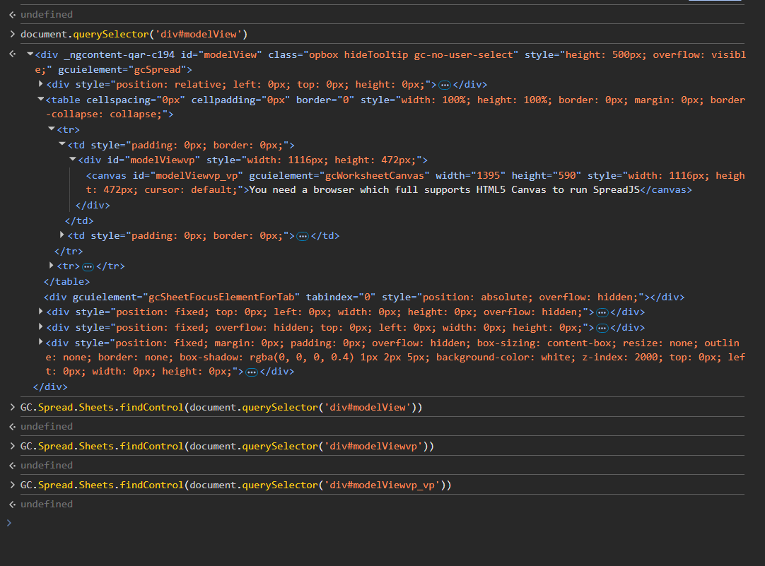

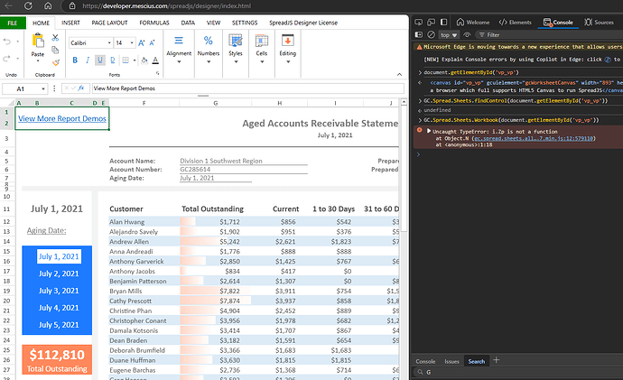

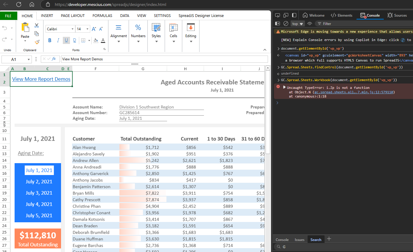

    In the following URL: https://developer.mescius.com/spreadjs/designer/index.html
    I’m trying to access the spread sheet using GC.Spread.Sheets.findControl. Its returning undefined. I checked with different locators. But no use. I’ve struggling with this for the past 2 days.
    Please check the screenshot for more details.

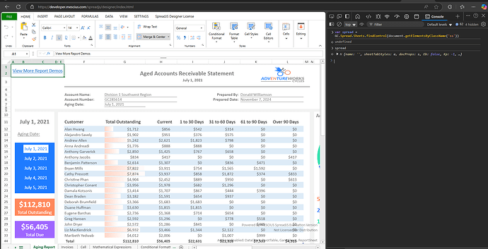

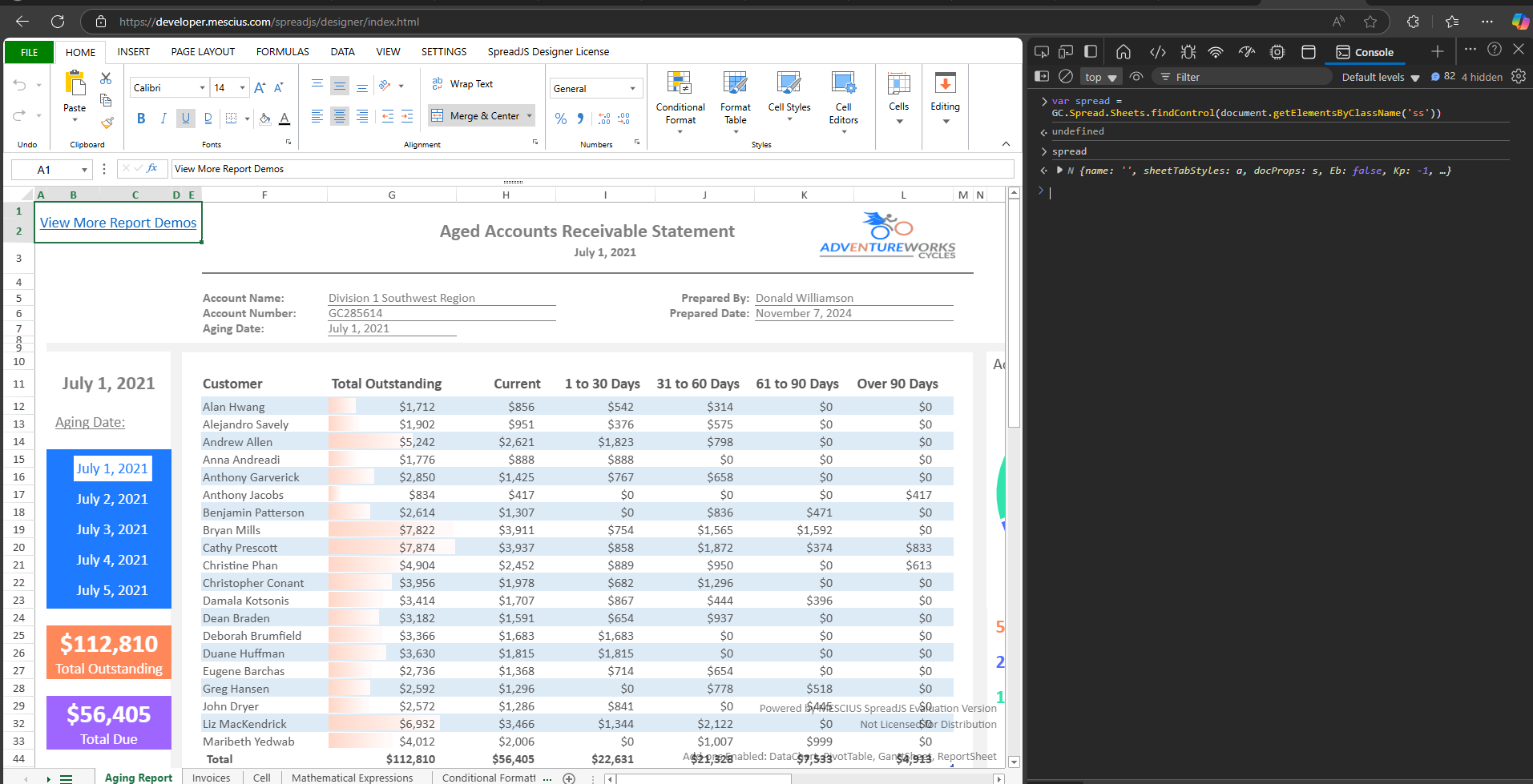

    You can use the below code snippet for getting the spread Object from the console.
    Code Snippet:-
    var spread = GC.Spread.Sheets.findControl(document.getElementsByClassName('ss'))
    Output:-

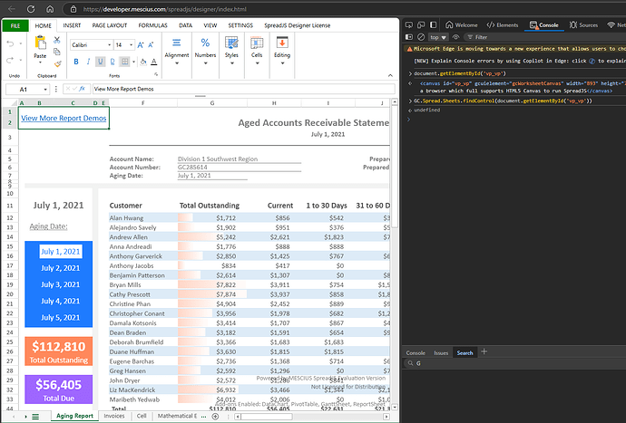

    Yes, that worked. Any reason why it didn’t work when I use the ID locator strategy?
    Another issue is, this scenario it worked. I’ve a similar scenario where I’m unable to find the control of the spreadsheet. How can I trouble shoot it. I used all the ways like chatgpt, etc but none of it helped.
    FYI - In the other scenario, As you did, I too passed the class name of the web element that has the gcuielement=‘gcSpread’ . Still its showing as undefined. I tried all the below possible ways but still got undefined.
    Yesterday I got all the elements and checked if any of it is an instance of the GC workbook, I found none of them.
    Kindly help me to resolve this issue.

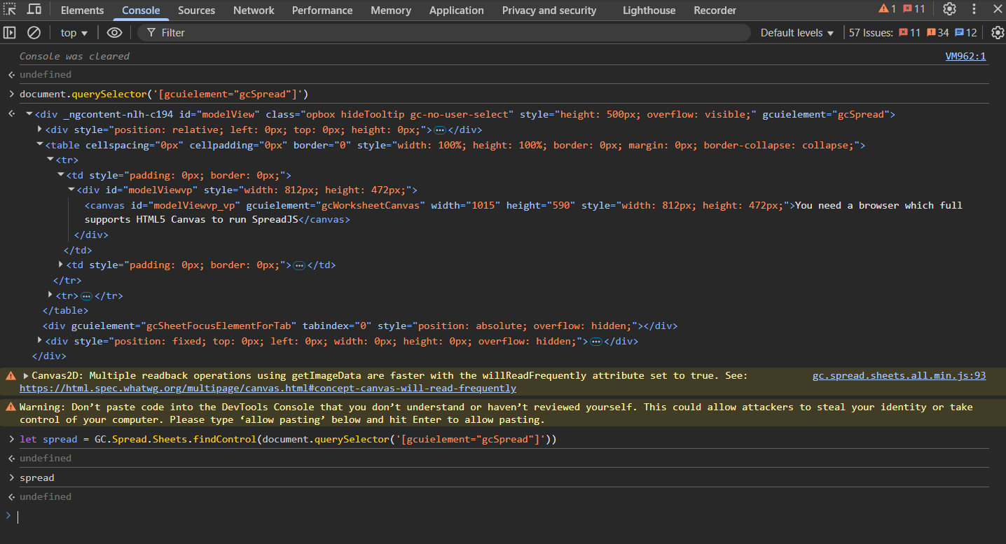

    Regarding the issue where you’re trying to get the Spread instance using the findControl method but receiving undefined:
    The findControl API is used to retrieve the Spread instance by passing either the host element’s ID or the host element itself. To identify the host element, you can check for the attribute gcuielement=“gcSpread”.
    If an element has this attribute, it is the host for the Spread instance.
    If this element has an ID, you can directly pass that ID to findControl to retrieve the instance.
    Alternatively, you can pass the HTML element itself.

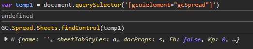

    However, in some cases, the ID might differ, or the structure might vary.
    In such situations, you can use the below snippet to find the element with the gcuielement=“gcSpread” attribute and then pass it to findControl:
    let spread = GC.Spread.Sheets.findControl(document.querySelector('[gcuielement="gcSpread"]'));
    Refer to the attached gif “Steps.gif” for a visual demonstration.
