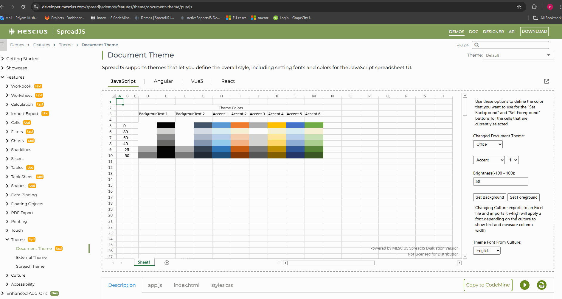

    Please refer to the attached GIF and this demo for more details:
    https://developer.mescius.com/spreadjs/demos/features/theme/document-theme/purejs
    Gif:
