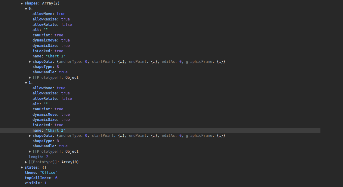

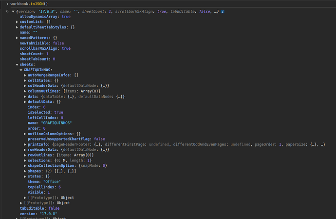

    How can i get the type of a Chart navigate in ‘workbook.sheets[0].shapes …’
    i can’t find a definition or enum of Chats.
    Here in this example i’ve two chats of different types, i’d know the types of it.
  • Posted 11 June 2024, 4:32 am EST - Updated 11 June 2024, 4:37 am EST
    The JSON is meant for SpreadJS internal use only can be used for with our other product like GCExcel. You could use the SpreadJS API to get the chart type.

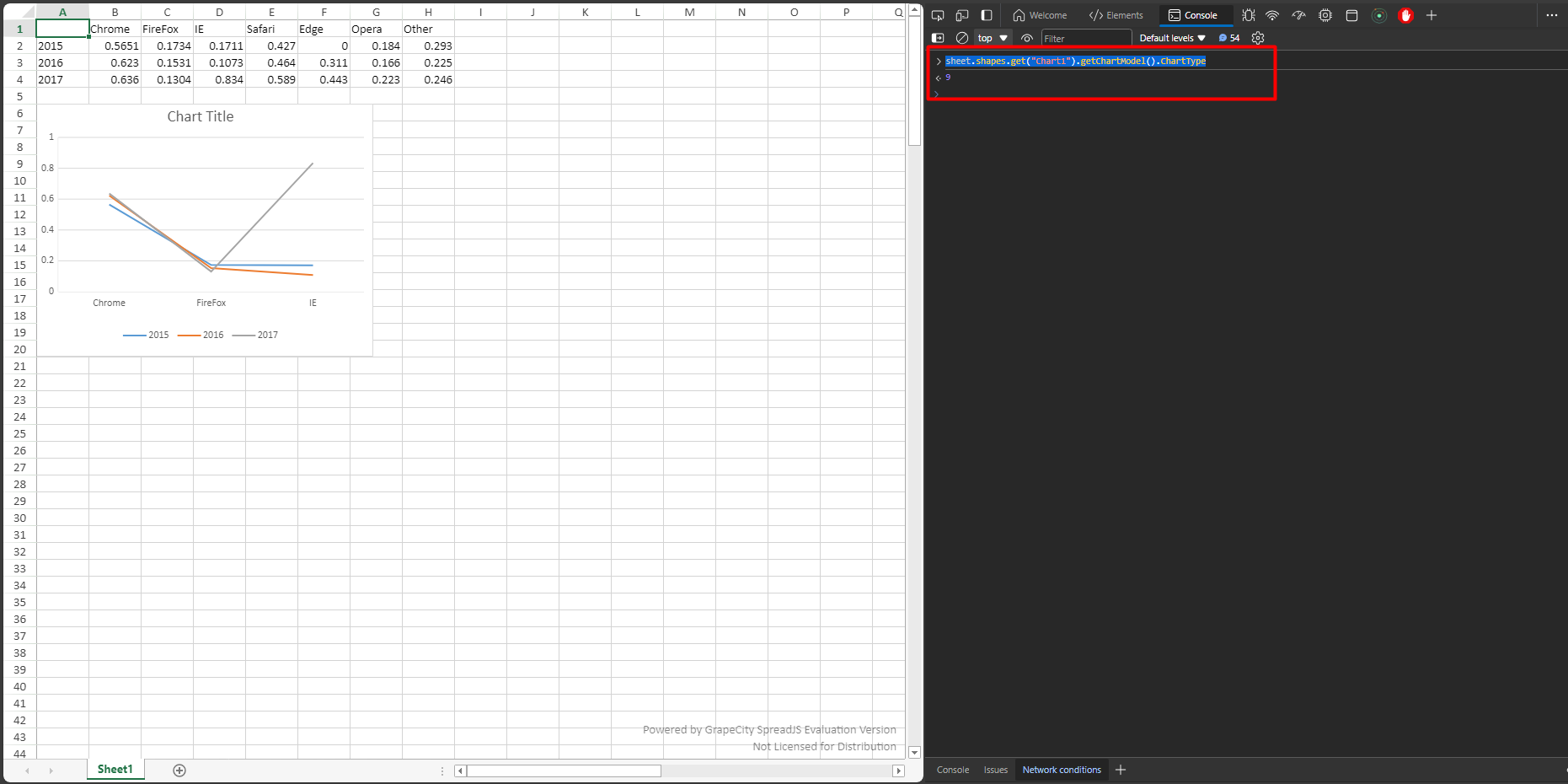

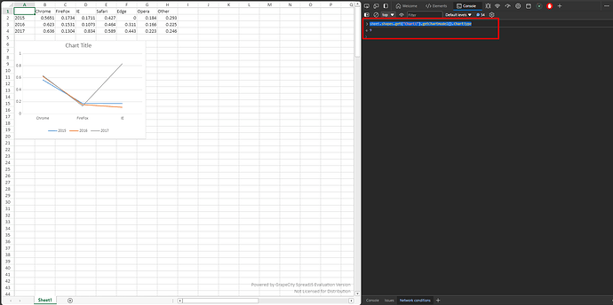

    You could refer to the following code snippet to get the Chart Type:
    sheet.shapes.get(“Chart1”).getChartModel().ChartType
    Kindly refer to the following screenshot:
    The Chart Type follows the following Enumeration: https://developer.mescius.com/spreadjs/api/enums/GC.Spread.Sheets.Charts.ChartType
