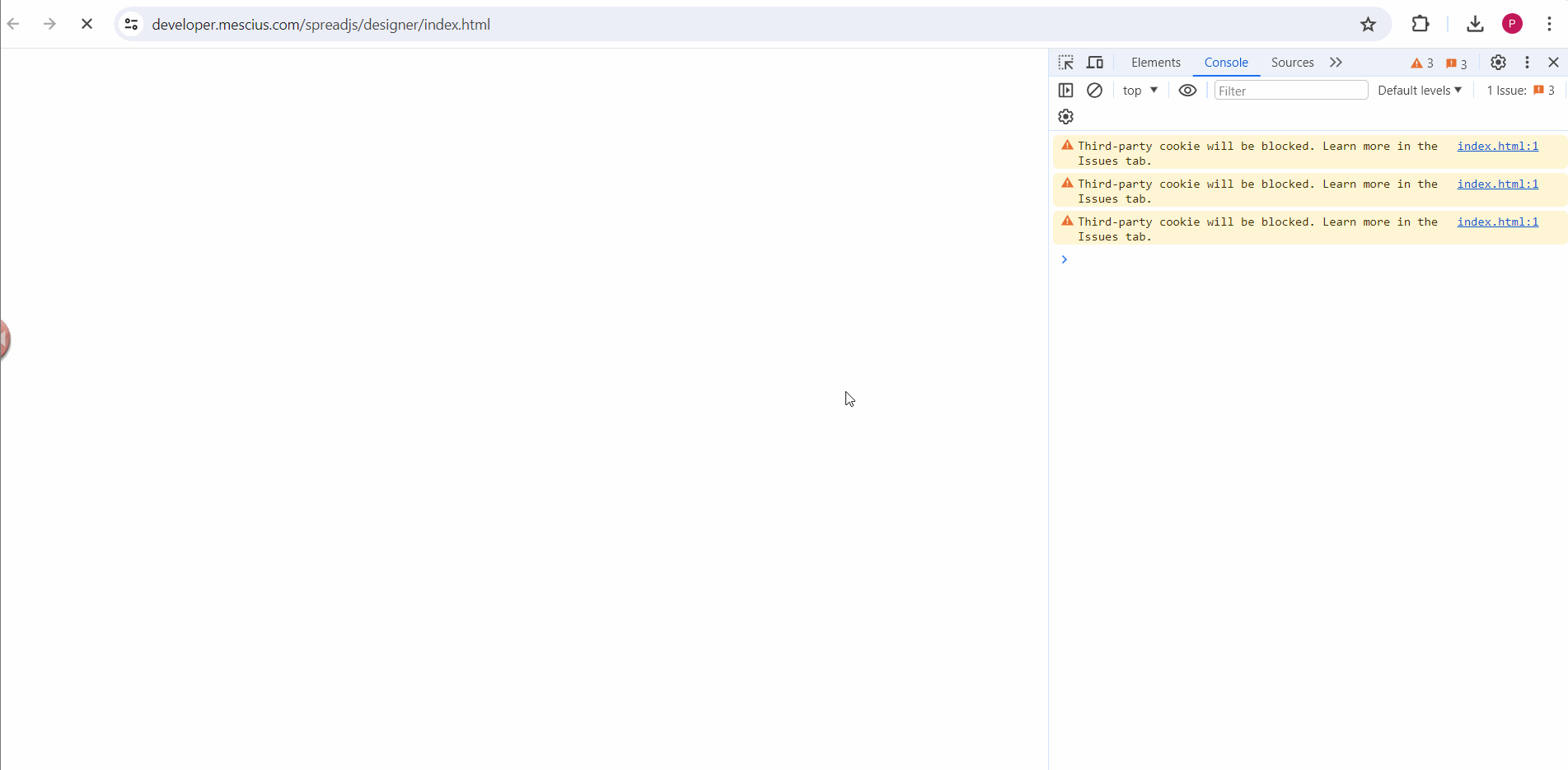

    Based on my understanding, when you copy a cell value from SpreadJS and paste it, the copied value includes the line break.
    This is expected behavior and the same with Excel. And With clipboardOptions, you cannot exclude this line break. However, If you want to copy the value without the line break, you can do so by double-clicking the cell. You can refer to the attached gif “Steps.gif”.
    GIF:
