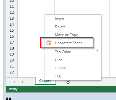

    3. The last place I have found is on the context menu by right-clicking on the tab itself. This shows the option to “Move or Copy…” the sheet, for example, but also the option to Unprotect the sheet - but I have not found a way to stop this menu option from showing up.

  • Posted 6 July 2023, 8:29 am EST - Updated 6 July 2023, 8:34 am EST
    Hi Mark,
    Currently, there is no global option or event to prevent the user from unprotecting the sheet.
    However, you could override the onOpenMenu method, check if the sheet is protected, and then remove the context menu option from the list of available options.
    Kindly refer to the following code snippet and the attached sample:

  • Posted 6 July 2023, 11:13 am EST
    Wow! That seemed to work. Thank you so much. I’ll get back to you if I have any other problems (or find another Unprotect Sheet option somewhere!)
