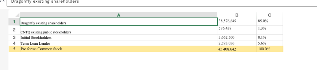

Highlight a row in spreadJS
Posted by: pavloboiko on 27 May 2025, 3:57 am EST
Posted 28 May 2025, 2:41 am EST
Based on your requirement to highlight a row when any changes occur within it, you can achieve this using the ValueChanged event. This event is triggered whenever a cell’s value changes. Within the event handler, you can retrieve the row index and sheet instance, then use the getRange API to target the entire row and apply a background color using the backColor method.
Please refer to the following snippet and sample: https://jscodemine.mescius.io/share/I6zjIlDAVEqhXZJqXLumug/?IsEmbed=false&Theme=Unset&PreviewDirection=0&IsEditorShow=true&IsExplorerShow=true&IsPreviewShow=true&IsConsoleShow=true&IsRunBTNShow=false&IsResetBTNShow=false&IsOpenInCodemineBTNShow=false&PanelWidth=20&PanelWidth=50&PanelWidth=30&defaultOpen={"OpenedFileName"%3A["%2Findex.html"%2C"%2Fpackage.json"%2C"%2Fsrc%2Fapp.js"]%2C"ActiveFile"%3A"%2Fsrc%2Fapp.js"}
spread.bind(GC.Spread.Sheets.Events.ValueChanged, (e, info) => { info.sheet.getRange(info.row, -1, 1, -1).backColor("#f7cb52"); info.sheet.getCell(info.row, 0, GC.Spread.Sheets.SheetArea.rowHeader).backColor("#f7cb52"); });
