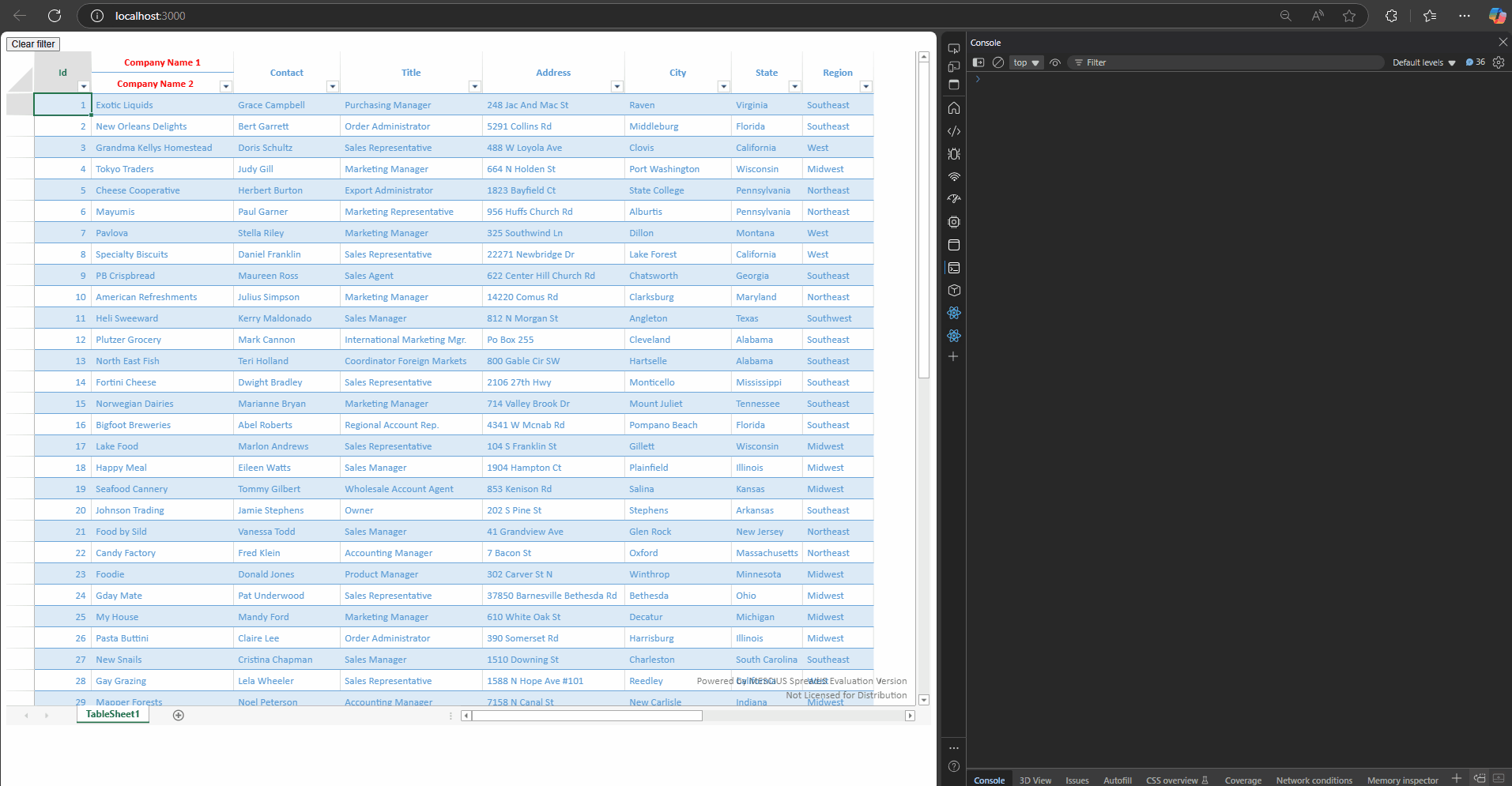

    Regarding “Is there a way to check if TableSheet is being filtered?” – You can track filtering actions in TableSheet using the filterTextSelectAction and filterByCondition commands via the CommandManager. These commands are triggered internally whenever a filtering operation is performed on the TableSheet.
    To detect when a filter is applied, you can add a listener to the CommandManager as shown below:
    spread.commandManager().addListener('appListener', (args) => {
        if (args.command.cmd === "filterTextSelectAction" || args.command.cmd === "filterByCondition") {
            console.log("TableSheet filtered!");
    How It Works:
    • The CommandManager listens for filter-related actions.
    • If the command matches “filterTextSelectAction” or “filterByCondition”, it logs a message indicating that filtering has been applied.
    Please refer to the attached GIF and sample for further reference.
