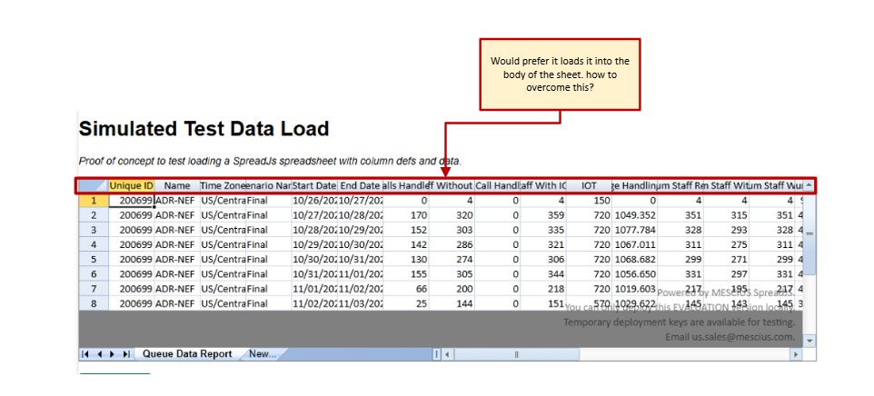

    When I use the sheet.setDataSource() and bind the headers I see the headers cover up the letters of the column coordinate section :

    I don’t want the columns in this area:

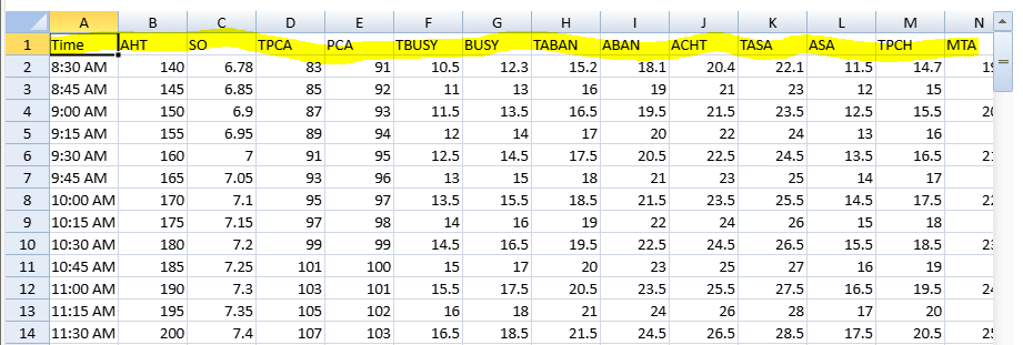

    Would prefer to see the columns in the spreadsheet area like this:
    How to acheive this using the functions in the snippet above?

  • Posted 17 March 2025, 5:15 am EST
    There is no way to retain the default column names and add the column names in the first row of the viewport sheet area. To accomplish the required, it is necessary to convert the data source into an array with column headers as the first row and add the data to the sheet using the setArray method or setDataSource method of the Worksheet class.
    Please refer to the code snippet below, which illustrates the above:
    const dataArray = [
      spreadJSColumnDef.map((h) => h.displayName),
      ...spreadJsData.map((row) =>
        spreadJSColumnDef.map((h) => row[h.name])
    sheet.setDataSource(dataArray);
    You can further refer to the attached sample that uses the above code snippet and binds the data to the sheet: SpreadJSWithKendoButtons.zip. Please note that this approach will work as expected to display the data but does not work according to the intended data source features.
