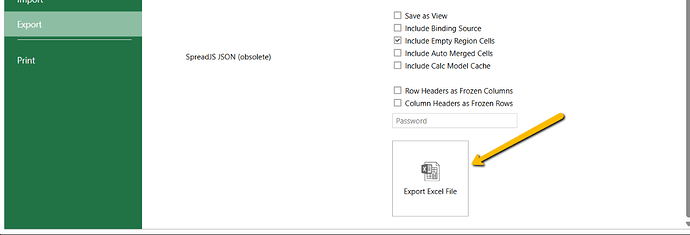

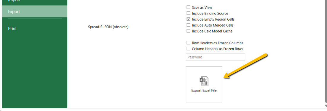

    I have a matter with the function exporting Excel file on the menu as the attachment .
    On the UI, I added a column that is a checkbox as the attachment file (web-ui-spreadjs.png).
    I used the function export to excel file on the menu. But, the file only show the value True/False on the Cell.

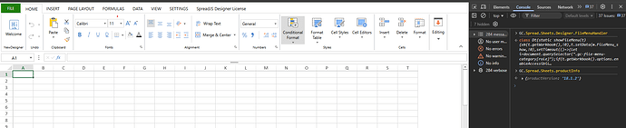

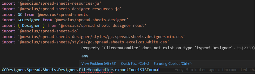

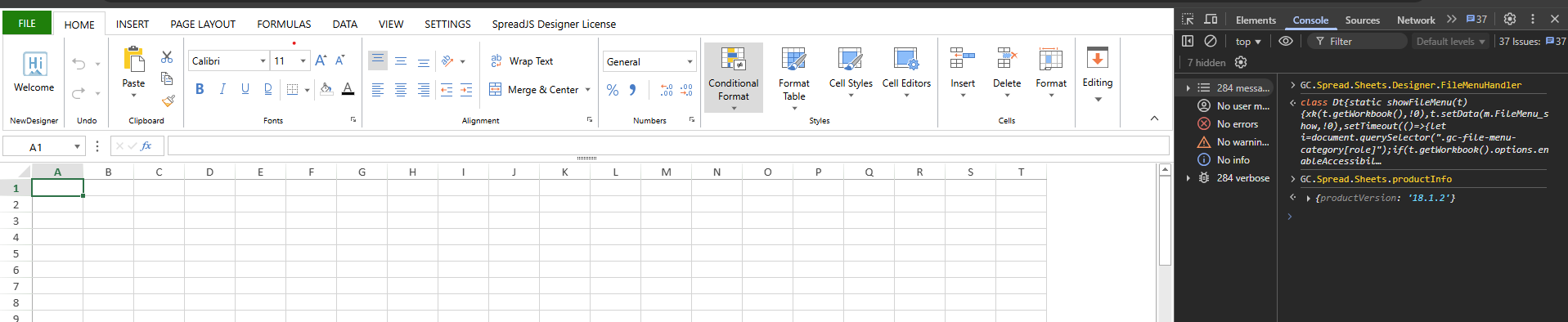

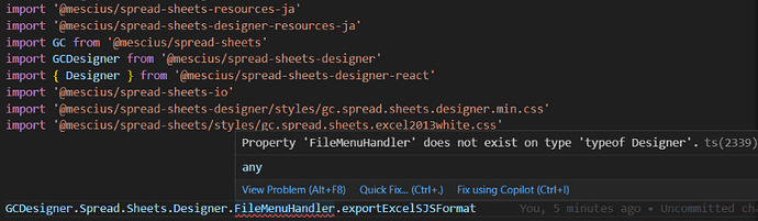

  • Posted 7 July 2025, 8:30 am EST - Updated 7 July 2025, 8:36 am EST
    The FileMenuHandler is available in version 18.1.2 as well — please refer to the attached image for reference.
    However, it’s not defined in TypeScript since it’s intended for internal use. You can bypass the TypeScript error by using
    any
    Regarding your question: “Can you please let me know how I can customize the print action from the ribbon menu?” — could you please clarify the type of customization you’re looking for, along with an example? This will help us better understand your requirement and assist you accordingly.
