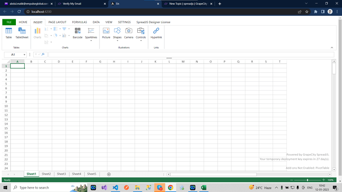

    This is Abdul here, we are in a situation to make the pivot-addon enabled in the Angular Application. We did installed and imported all the packages such as excelio, pivot-addon, shapes, designer, designer-angular, designer-resources-en, charts but it still continues to show the message that the pivot table add-on has not been enabled. The pivot Table option is not visible in designer also.

    HI,
    For the localhost, if you are seeing this message that means you have not added the pivot package. For other hostnames, if you are seeing this message that the license key that you using does not have a pivot panel addon.
    sample: https://jscodemine.grapecity.com/sample/EUOU5UpltEy8HlIMO-v7oQ/
    Avinash
  • Posted 13 January 2023, 2:20 am EST
    Also we noticed that, You are using license key if it is the case your license key probably does not include pivot addon.
