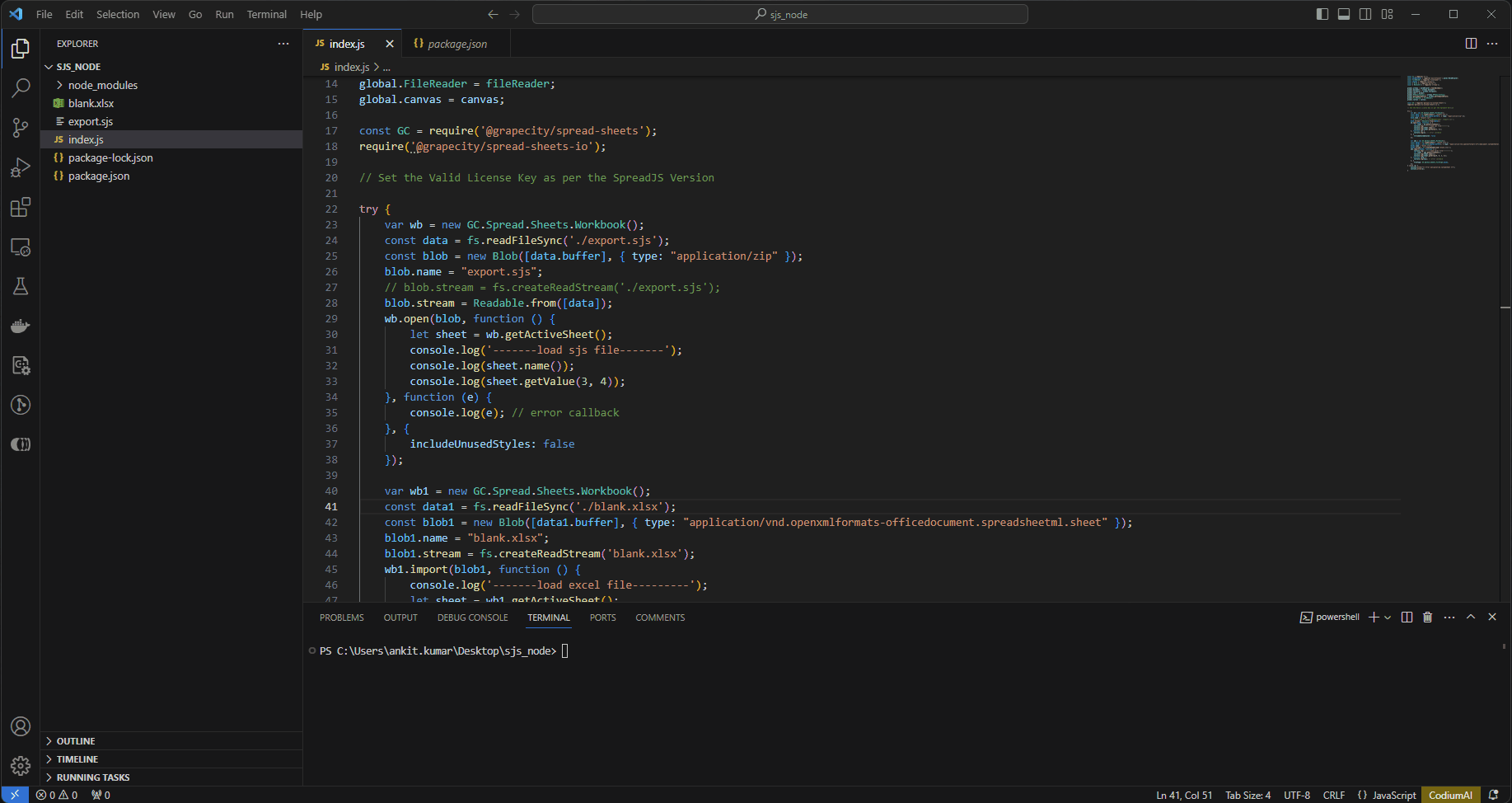

  • Posted 29 January 2024, 7:11 am EST - Updated 29 January 2024, 7:16 am EST
    I tested with the mentioned code snippet i.e.,
    blob.stream = Readable.from([data]);
    and it is working as expected. The error might happen if you have not set the License Key for V17 or an invalid License Key is set.
    Could you kindly set a valid License Key and try again? If you are still face the issue, kindly do share the sample along (with the License Key that you are using) with us by creating the ticket on our private portal at: https://developer.mescius.com/my-account/my-support
    Kindly don’t share the License Key on public forum. You may refer to the attached gif that shows the steps I have performed.
    Ankit
