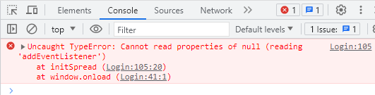

    Hi Chandan,
    Please find attached my sample file and error I am getting. Can you please have a look at it and let me know why its not wotking.

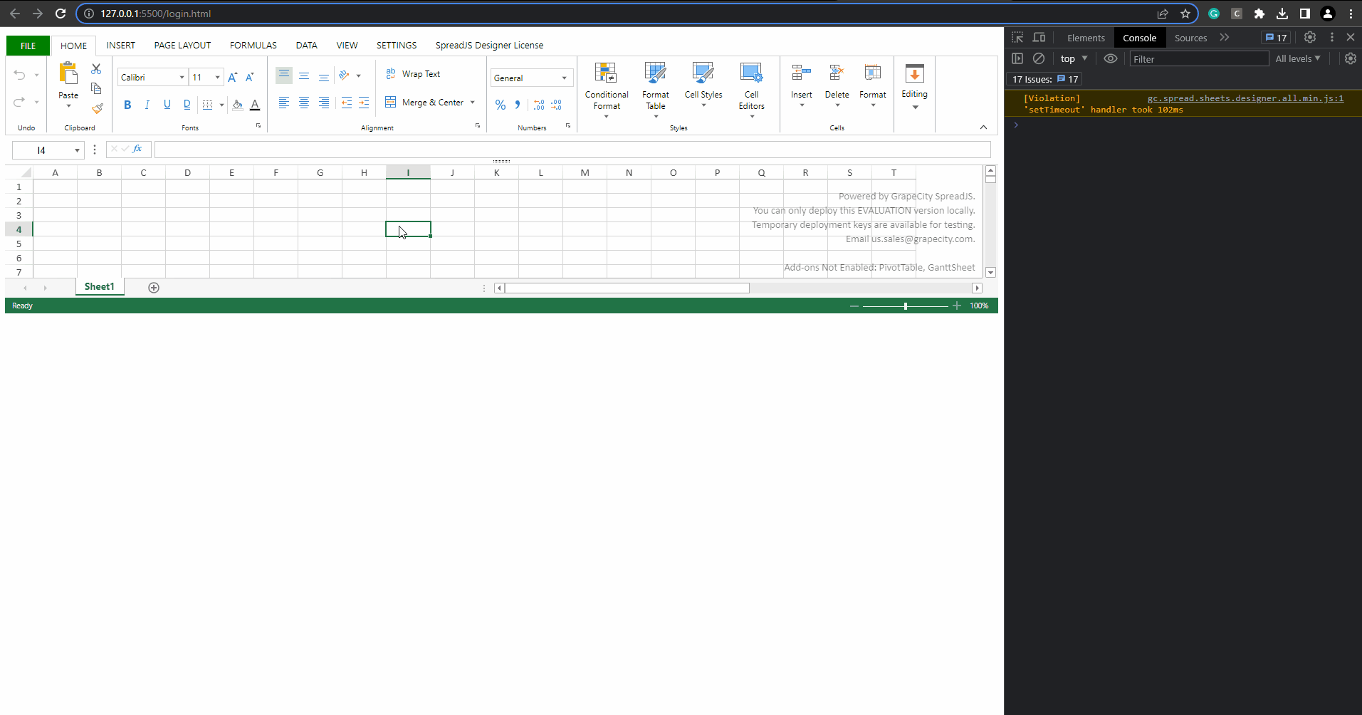

    Hi Priya,
    After investigating the sample provided by you, we found that the designer files were missing from the sample. Also, the error was thrown because the “spread” object was undefined as it was not initialized properly at line no. 66 in “login.html” file.
    Additionally, we have added a style.css file to style the custom context menu.
    Please refer to the attached sample.
    solution.zip
    In the attached sample, we have added code lines 13~15, 48~52, 103~104, and commented code lines 66~67 in “login.html” file.
    Please note that the custom context menu in the provided sample covers very basic functionality. You would need to implement your own custom context menu for your specific use case and functionalities.

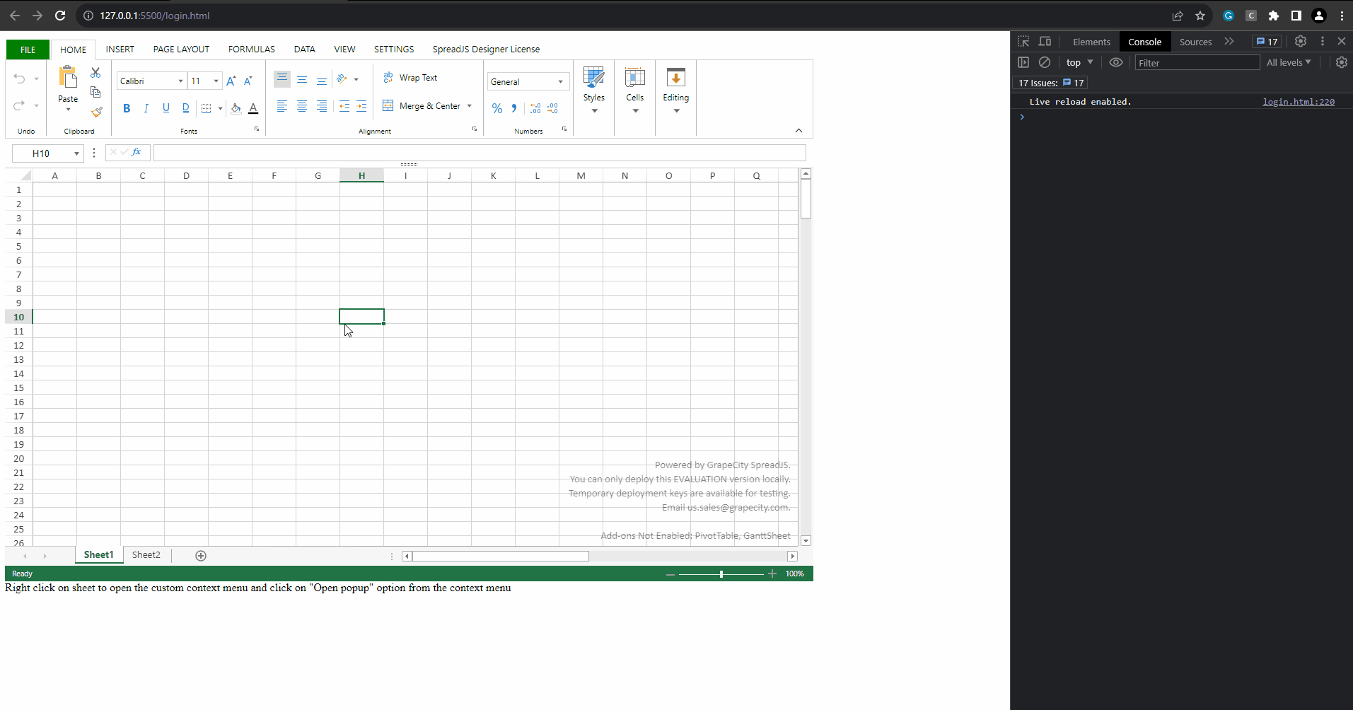

  • Posted 11 September 2023, 7:29 am EST - Updated 11 September 2023, 7:34 am EST
    You can open the popup menu by binding an event listener to the ‘click’ event of the option element of the custom context menu. The event listener then opens a custom popup.
    Please refer to the attached sample and GIF.
    sample: solution.zip
    In the attached sample, the function createPopupElement() is used to create HTML for popup. This method is called when the click event listener of the context menu option(“Open Popup”) is invoked.
    Please note that in the attached sample, a basic custom context menu and popup are implemented. This is just to explain how a custom context menu and popup can be implemented in SpreadJS. However, you would need to create your own custom context menu and popup based on your requirements.
