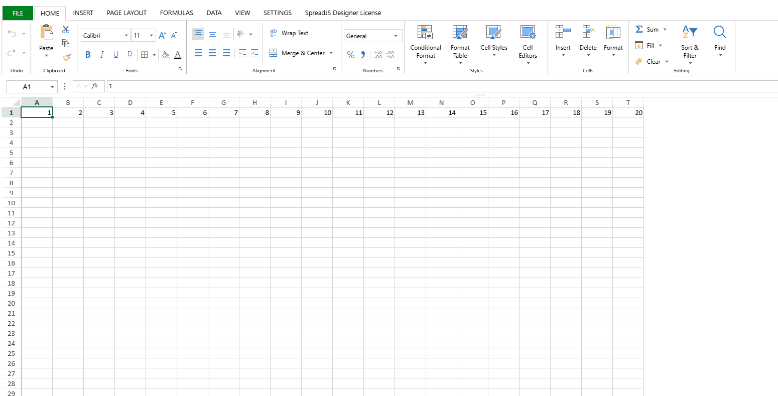

    I am trying to implement this in Designer component in ReactJS. I now understand the code sent in your sample but unable to replicate it in ReactJS. The new context menu item does not get visible on UI. Here is what I tried:- https://jscodemine.mescius.io/sample/B6_wsKtFWEKuX4WVLDuqvw/ Kindly help in finding why similar code is not working.

    In the case of the SpreadJS designer component, the custom context menu item is added to the designer config and not to the SpreadJS CommandManager. Please refer to the code snippet below that adds the custom context menu to insert columns to the right in the Designer.
    function addCustomContextMenuItem(designer) {
        let config = GC.Spread.Sheets.Designer.DefaultConfig;
        if (config && config.contextMenu) {
            config.contextMenu.push("insertColumnRight");
        config.commandMap = {
            "insertColumnRight": {
                text: "Insert Column Right",
                commandName: "insertColumnRight",
                visibleContext: "ClickColHeader",
                execute: function (context, _, options) {
                    const spread = context.getWorkbook();
                    const sheet = spread.getSheetFromName(options.sheetName);
                    const selections = options.selections;
                    const colSelections = selections
                        .filter(item => item.row === -1)
                        .sort((a, b) => b.col - a.col)
                        .map(({ col, colCount }) => ({ col, colCount }));
                    colSelections.forEach(colSelection => {
                        sheet.addColumns(colSelection.col + colSelection.colCount, colSelection.colCount);
                    return true;
        designer.setConfig(config);
    You can further refer to the attached code sample that uses the above code snippet and provides the functionality to add columns to the right in the SpreadJS Designer (see below).
    Sample: https://jscodemine.mescius.io/share/L3BfQOa2okWLw5MfN_Cu-w/?defaultOpen={"OpenedFileName"%3A["%2Fsrc%2Fapp-func.jsx"]%2C"ActiveFile"%3A"%2Fsrc%2Fapp-func.jsx"}

  • Posted 11 April 2025, 10:20 am EST
    Thank you. This worked.
