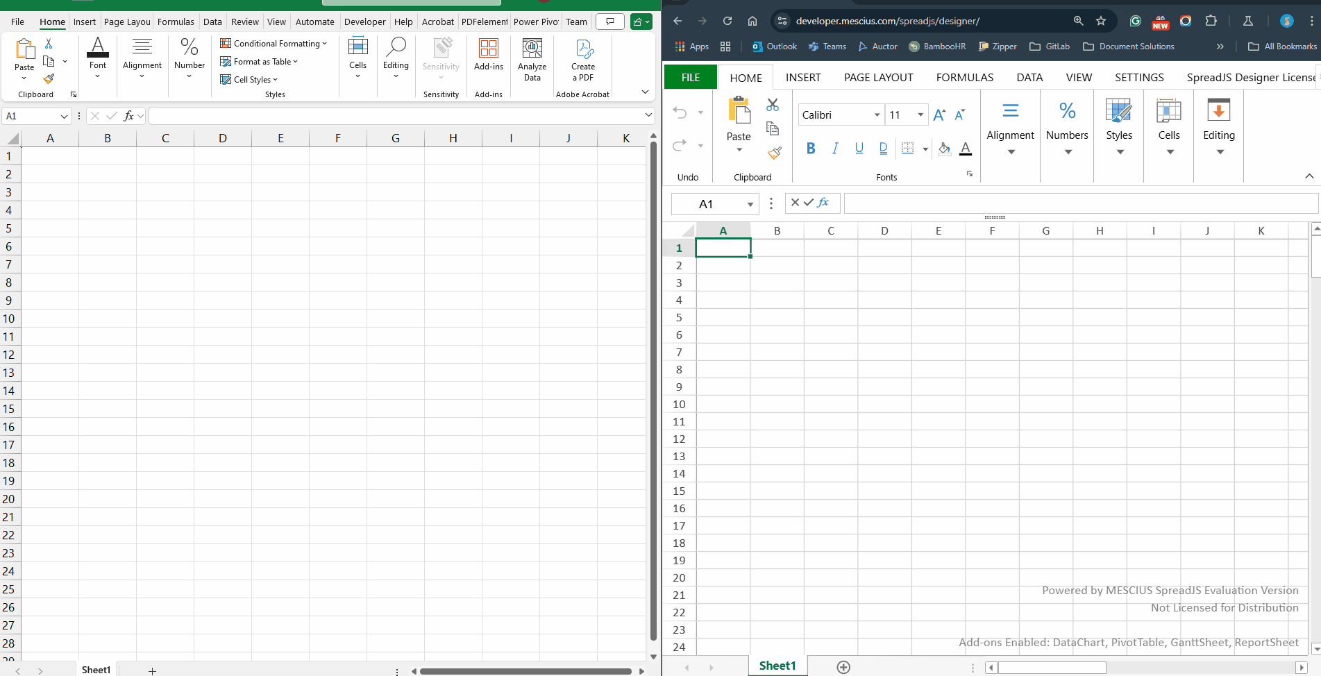

    We can replicate the behavior you mentioned on our end. However, the same behavior is shown by Microsoft Excel and it is not a bug. In SpreadJS, the iterative calculations are ON by default which is why it calculates to a value, everytime a value changes in the SpreadSheet cells.
    Please refer to the attached screen recording which illustrates similar behavior of SpreadJS and Microsoft Excel:
