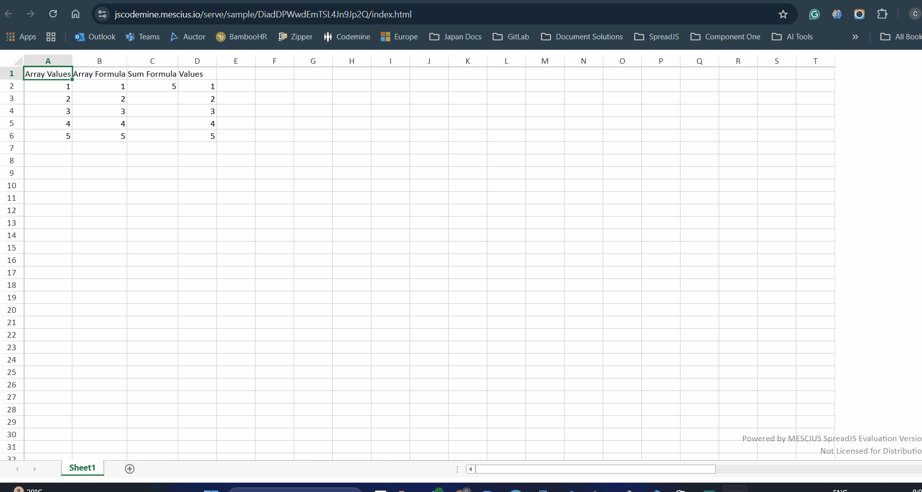

    In case it is required to keep the existing formula and not trigger the delete key action, the same can be achieved with the above code snippet by not setting the array of zeroes in the required cell range.
    You can further refer to the attached sample that uses the above code snippet and handles the delete operation (see below).
    Sample: https://jscodemine.mescius.io/share/uvKAiIUMIEGU0fmyx6logA/?defaultOpen={"OpenedFileName"%3A["%2Findex.html"%2C"%2Fapp.js"]%2C"ActiveFile"%3A"%2Fapp.js"}
    GIF:
    Please let us know if you require any further assistance.
