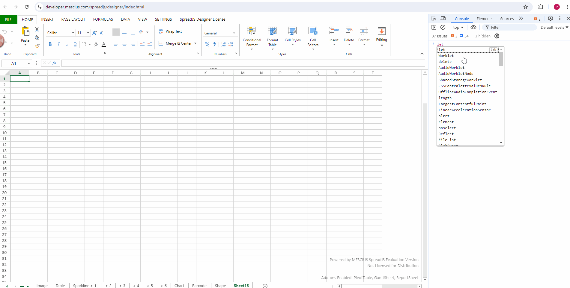

    If you want to lock and make the last column visible, you need to select the whole column by using -1 for the row and rowCount arguments in the getRange function. Refer to the attached snippet and gif “SpreadJS.gif.”
    let activeSheet = spread.getActiveSheet();
    activeSheet.getRange(-1, 19, -1, 1).locked(true);
    activeSheet.getRange(-1, 19, -1, 1).visible(false);
    // Or
    // activeSheet.setColumnVisible(19, true);
    Instead of the visible method, you can also use the setColumnVisible API to hide and unhide the column.
