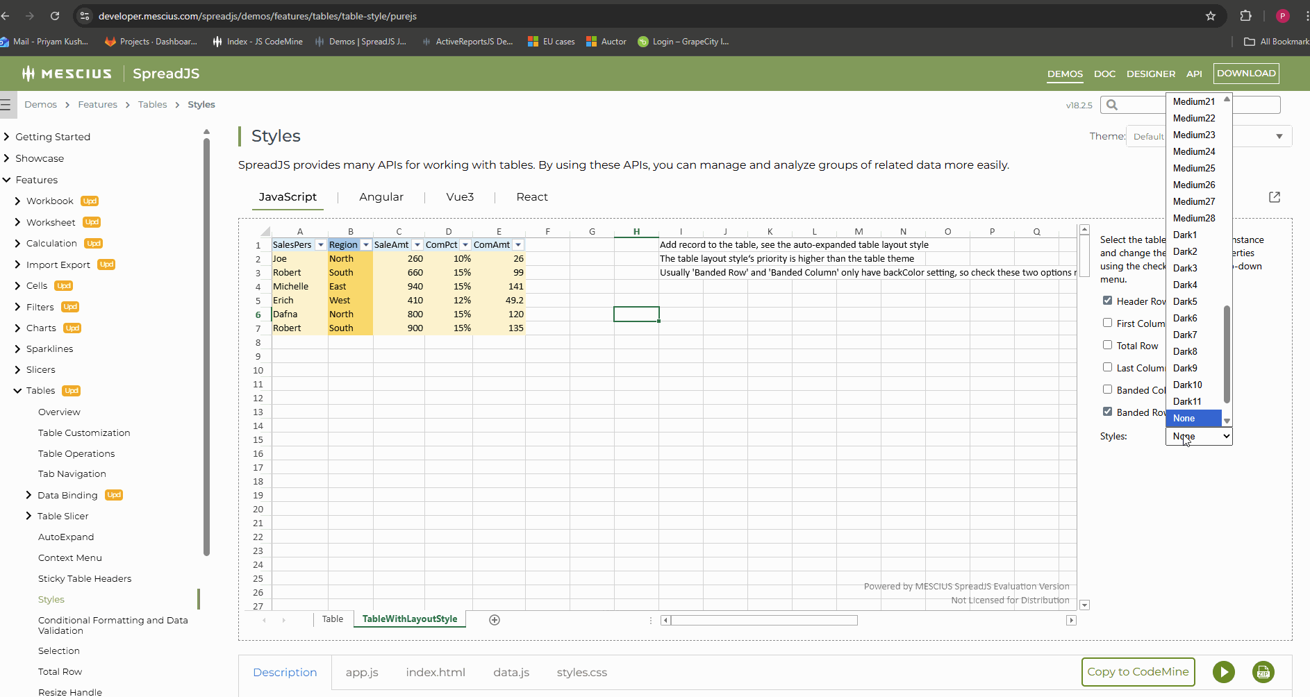

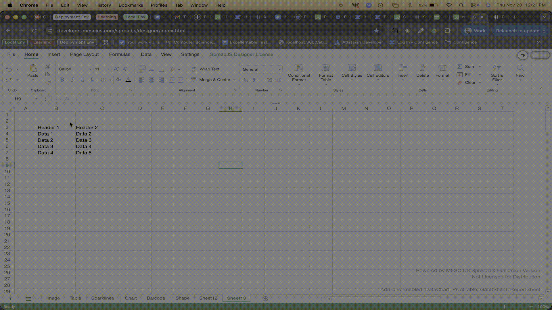

I’m not entirely sure about the behavior you’re trying to replicate, as both Designer and SpreadJS already preserve existing cell styles when a table format is applied. You can refer to this demo: https://developer.mescius.com/spreadjs/demos/features/tables/table-style/purejs and also check the GIF below.
GIF:
Both Designer and SpreadJS maintain cell styles by default, so there’s no need to handle this manually.
If my understanding is incomplete, could you please provide more details with an example of your exact use case? This will help us better understand the scenario and assist you accordingly.
