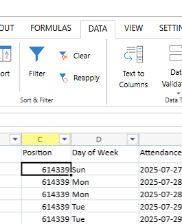

    Because I am no longer adding data to the sheet via:
    sheet.setDataSource(data[i].data);
    and adding the data manually… is there a way to filter everything but the column headers that I have stuck in the sheet?
    The popup window includes the the first row which is the header… which is expected…I guess.
    Is there a way to not include the first header row.

    As I understand, you’re manually adding data to the sheet, with the first row being used as the header, but it’s also getting included in the filter.
    From the image, it appears that the filter is being applied to the entire range including the header row, which is why it shows up in the filter options and gets filtered as well. To prevent this, you can define a specific filter range using the rowFilter method, which allows you to exclude the header row.
    Refer to the snippet below and the attached “Sample.zip” for reference:
    // Apply filter excluding the first row
    sheet.rowFilter(new GC.Spread.Sheets.Filter.HideRowFilter(
        new GC.Spread.Sheets.Range(1, 0, 6, 3)
    Sample: Sample.zip
