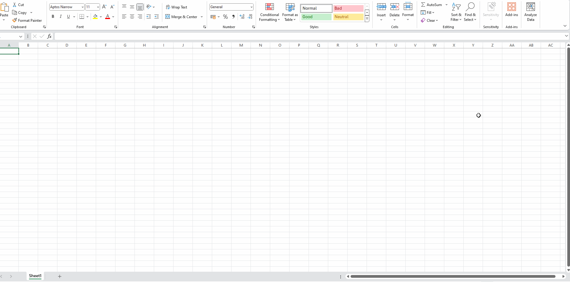

    Based on my understanding, you’ve used a non-breaking space special character in cells B1 and C1 in last. When importing the Excel file, selecting these cells and entering edit mode for the first time displays the special character. However, upon 2nd attempt, the special character does not appear. Please refer to the attached GIF “Steps” for clarification.
    GIF:
    Could you kindly verify if you are referring to this behavior? However, I’ve escalated this matter, and the internal tracking ID assigned is “SJS-24204”. I’ll keep you updated as soon as I receive any further information.

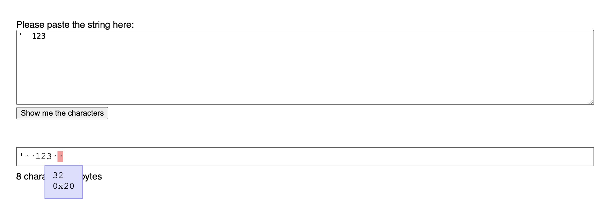

    After using the quote prefix, I noticed that non-breaking spaces (nbsp) persist after importing an Excel file in SpreadJS and exporting. Please refer to the attached gif “Steps.gif” and Excel file “Book1.xlsx”.
    Attachments: Attachments.zip
    If this does not meet your requirements, could you please provide more details about the exact use case and how you are attempting to achieve it? This will allow us to share the information with the development team for further process.
    Priyam
  • Posted 28 May 2024, 5:51 am EST - Updated 28 May 2024, 5:56 am EST
    Actually, after importing the Excel file in the Attachments you’ve sent - all those spaces appear as plain spaces and not as non-breaking ones
