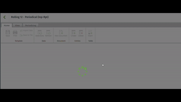

    I have a sheet which after opening it I am not able to edit the cell directly. I have to explicitly click the cell to enter some value. Please tell me some way to directly without clicking on the sheet to edit the cell or type directly into it

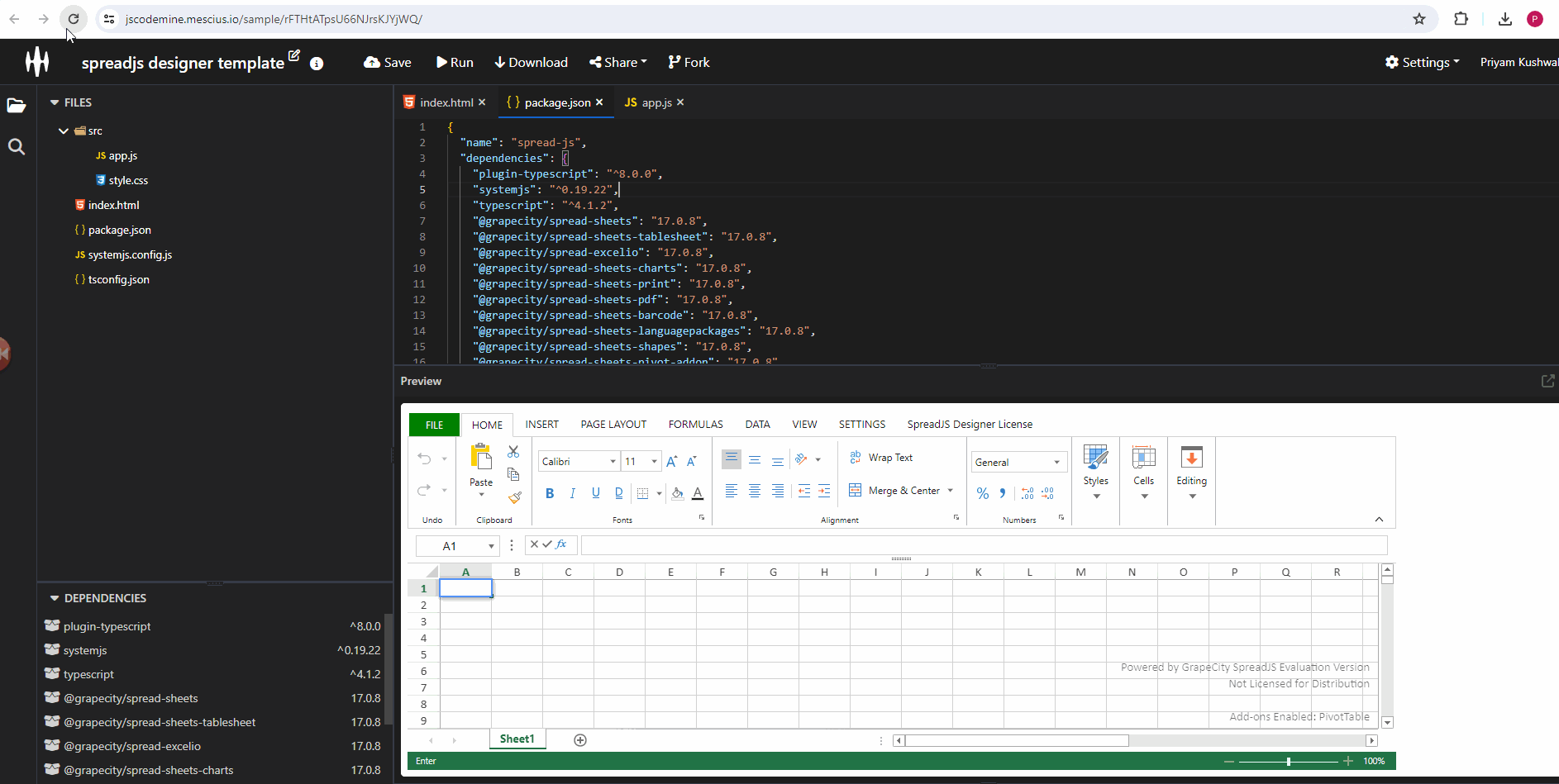

    As per my understanding, you want the active cell to enter edit mode as soon as starts typing when SpreadJS loads, but it seems this isn’t happening on your end.
    I attempted to reproduce this issue but was unsuccessful. On my end, when I start typing after SpreadJS loads, the active cell enters edit mode as expected. Please refer to the attached gif “autoFocus.gif” and sample.
    GIF:
    Sample: https://jscodemine.mescius.io/share/it52AbL3jkKDXcPbPOu12A/?defaultOpen={"OpenedFileName"%3A["%2Findex.html"%2C"%2Fpackage.json"%2C"%2Fsrc%2Fapp.js"]%2C"ActiveFile"%3A"%2Fsrc%2Fapp.js"}
    To better assist you, could you share a sample along with the steps to replicate the behavior you have observed, or modify the existing sample to replicate the behavior? This will enable me to investigate the problem more thoroughly. And It would be helpful if you could provide a GIF or video illustrating the issue.

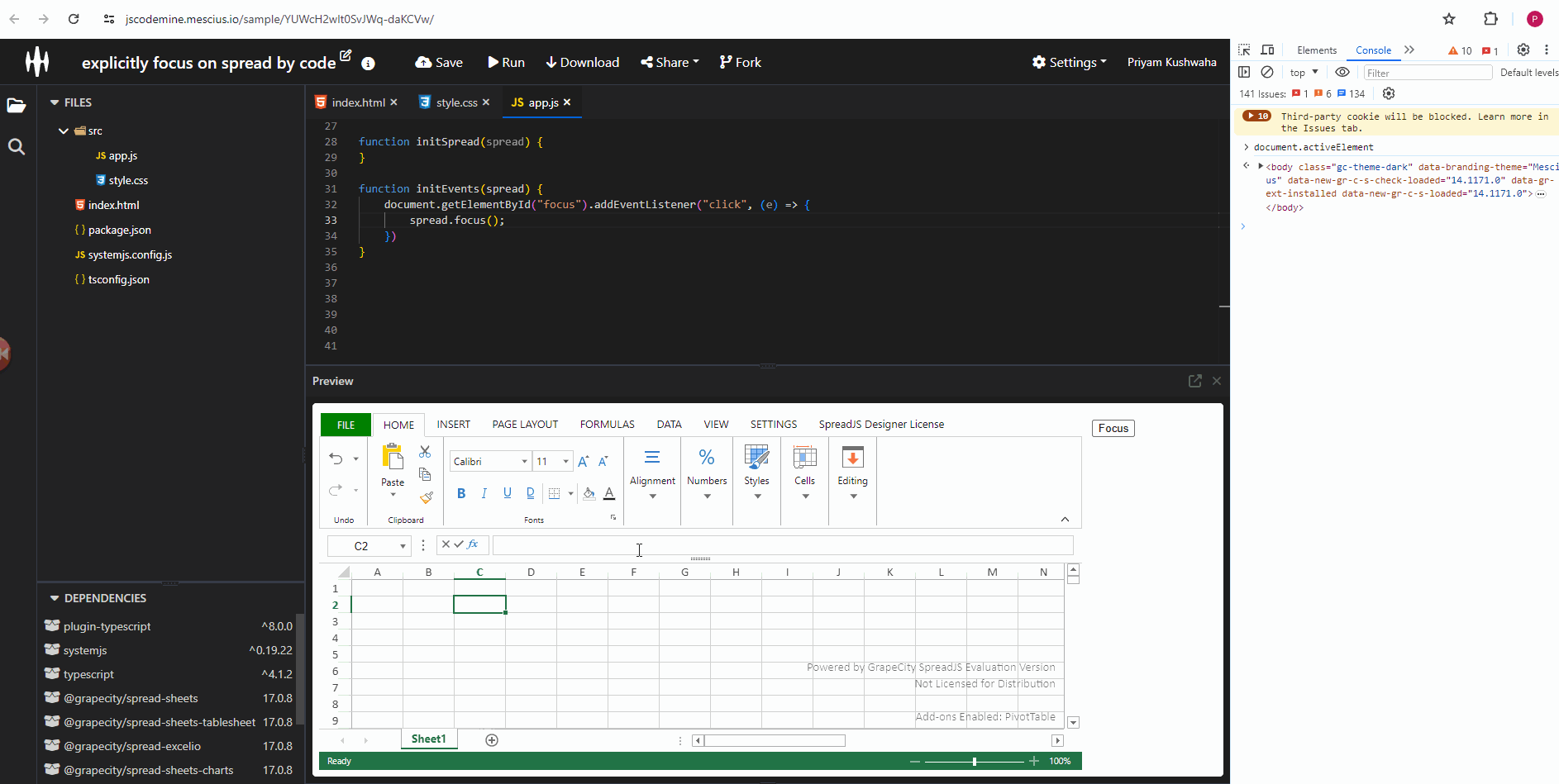

    You can explicitly focus the SpreadJS by utilizing the “focus” method of SpreadJS, which directs the focus onto the Spread component. Please refer to the attached GIF labeled “focus.gif” and the provided sample for clarification.
    GIF:
    Sample: https://jscodemine.mescius.io/share/--q0dDR7VEqaQQhU6IkSDw/?IsEmbed=false&Theme=Unset&PreviewDirection=0&IsEditorShow=true&IsExplorerShow=true&IsPreviewShow=true&IsConsoleShow=true&IsRunBTNShow=false&IsResetBTNShow=false&IsOpenInCodemineBTNShow=false&PanelWidth=20&PanelWidth=50&PanelWidth=30&defaultOpen={"OpenedFileName"%3A["%2Findex.html"]%2C"ActiveFile"%3A"%2Findex.html"}
    I’m uncertain why this behavior is not the default on your end, as it appears to be the default behavior on my end, as mentioned in a previous comment. Without a sample, it’s difficult to determine what might be causing this deviation in behavior. If the issue persists on your end, could you please provide a sample along with steps to reproduce the observed behavior? Alternatively, modifying the existing sample to replicate the issue would aid in a more thorough investigation.

    is it possible for me to click the active cell
    by default whenever the sheet opens I have to click the cell first to edit in mu codebase and its a little difficult to debug the issue so as an alternative is there any way that by through code I can click the active cell.
