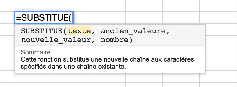

    in the functions like SUBSTITUE, how can I know which parameters are mandatory and which are optional? (In Excel optional ones appear with )

    I was able to replicate the issue at my end with the latest version of SpreadJS V17.0.8. I could see that for some formulas like “SUBSTITUTE” the optional parameters are not enclosed within “”.
    I have escalated this issue to the concerned dev team for further investigation. The internal tracking id for the same is: SJS-24224. I will let you know when there is more info on this from the dev team.
