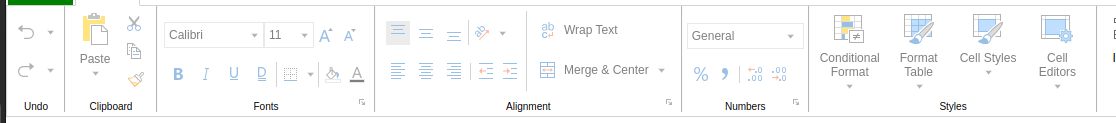

    When I protect the sheet the toolbar is blocked
    I would like to know if there is a way to protect the sheet without blocking the toolbar?

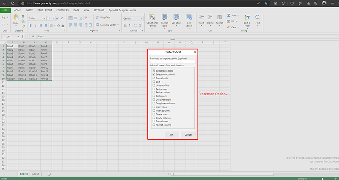

    Currently, there is no good way to unblock the toolbar without unprotecting the sheet. However, SpreadJS does allow options to allow users to perform some actions on the protected sheet as shown below.

    Of course, I would like to edit the unlocked cells (using the toolbar like bold, italics, colors…) even with sheet protection active.
    And in cells locked when clicking on a toolbar function, nothing happens.

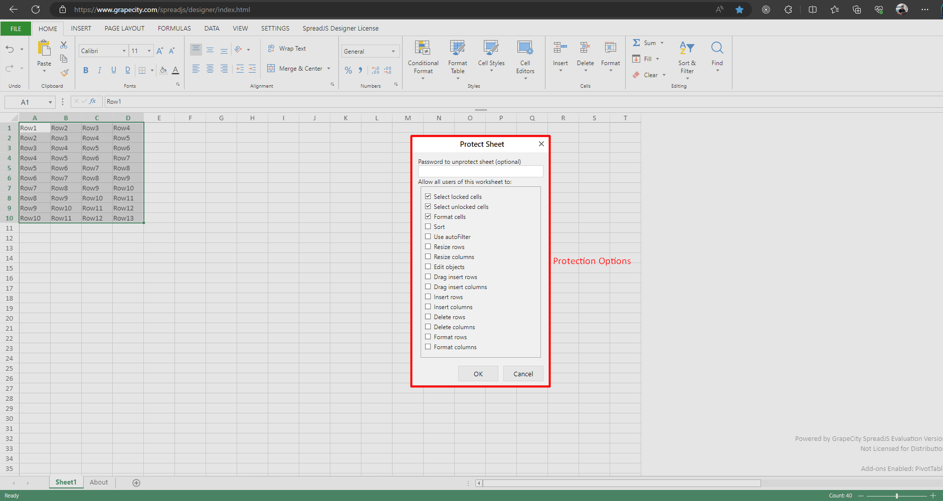

    When the sheet is protected, you cannot change the font, apply styles like bold, italics, color… to even the unlocked cells. This is by design, and it follows the Microsoft Excel’s policy.
    To apply the font, and other styles, you need to check the “Format Cells” option when protecting the sheet. Then you could apply the style to both the locked and unlocked cells same as the Microsoft Excel.

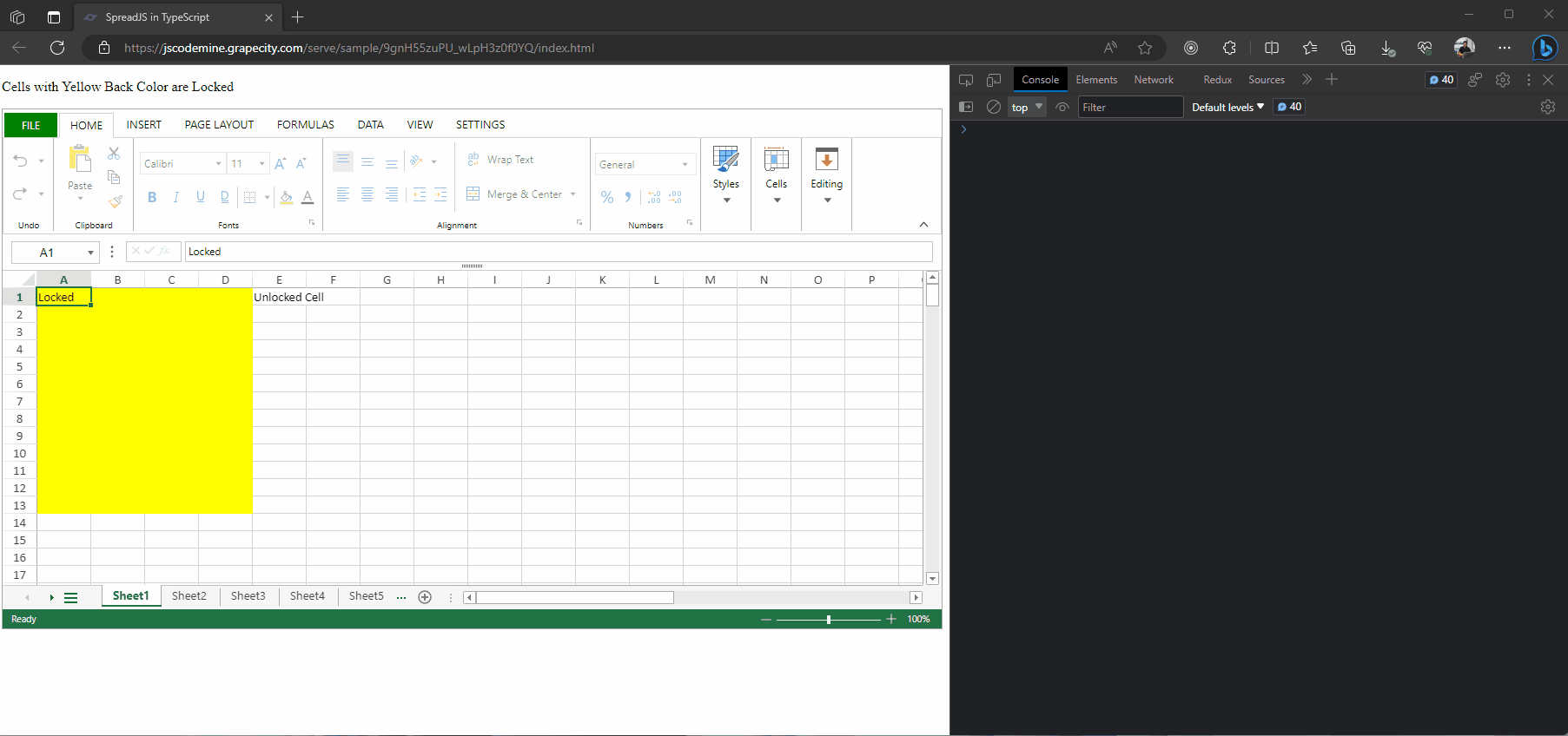

    It is possible to get the command name to be executed from within the config object and to get all the properties of the command, the getCommand method (https://developer.mescius.com/spreadjs/api/designer/modules/GC.Spread.Sheets.Designer#getcommand) of the Designer can be utilized.
    Please refer to the attached sample and the screenshot, which demonstrates how to inspect the config object (see below).
    You can also get the command without drilling into the config object by referring to the SpreadJS Designer CommandNames (https://developer.mescius.com/spreadjs/api/designer/classes/GC.Spread.Sheets.Designer.CommandNames). The page lists down all the commands used in the SpreadJS Designer, and you can inspect the command as required. Furthermore, all the designer-specific features are listed on SpreadJS Designer Namespace (https://developer.mescius.com/spreadjs/api/designer/modules/GC.Spread.Sheets.Designer), you can always refer to this documentation to learn how to deal with the SpreadJS Designer.
