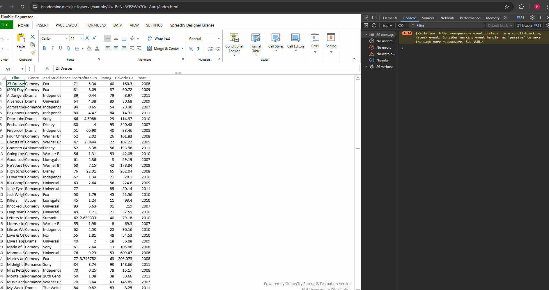

I wanted to know if I can render the separator conditionally in the menu tabs dropdown
Attaching the screenshot for the same

As I understand, you want to conditionally render the separator.
This can be done by dynamically modifying the configuration based on your conditions. Please refer to the attached GIF and sample: https://jscodemine.mescius.io/share/AN0NRQp8qUOeEK1chOwpIw/?IsEmbed=false&Theme=Unset&PreviewDirection=0&IsEditorShow=true&IsExplorerShow=true&IsPreviewShow=true&IsConsoleShow=true&IsRunBTNShow=false&IsResetBTNShow=false&IsOpenInCodemineBTNShow=false&PanelWidth=20&PanelWidth=50&PanelWidth=30&defaultOpen={"OpenedFileName"%3A["%2Findex.html"%2C"%2Fsrc%2Fapp.jsx"]%2C"ActiveFile"%3A"%2Fsrc%2Fapp.jsx"}
In this sample, a checkbox is used to simulate the condition under which the separator is added or removed.
