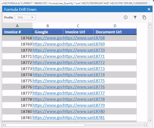

Posted 19 December 2023, 4:57 pm EST - Updated 19 December 2023, 5:02 pm EST
Hi Ankit, thanks for the updated solution. I tested and it works as expected.
There is one issue with the tooltip though related to the positioning. If the tooltip does not fit within the sheet, it results in tooltip being cropped and also additional scrollbars appear.
I have attached a screenshot of the issues.
It would be nice if you can advise a fix where the tooltip is always fully visible and the scrollbars don’t appear. -

This is the expected behavior as the tooltip is shown slightly right to the cell position. You could use the SpreadJS API to get the tooltip element and adjust its height.
For example, kindly refer to the following sample: https://jscodemine.grapecity.com/share/WJrz_rbEO02O6kjvIpm6hA/?IsEmbed=false&Theme=Unset&PreviewDirection=0&IsEditorShow=true&IsExplorerShow=true&IsPreviewShow=true&IsConsoleShow=true&IsRunBTNShow=false&IsResetBTNShow=false&IsOpenInCodemineBTNShow=false&PanelWidth=20&PanelWidth=50&PanelWidth=30&defaultOpen={"OpenedFileName"%3A["%2Fsrc%2Fapp.js"]%2C"ActiveFile"%3A"%2Fsrc%2Fapp.js"}
In the sample, I have adjusted the tooltip’s left position inside the processMouseEnter method. You could refer to all the methods available in the HyperLink Class: https://developer.mescius.com/spreadjs/api/classes/GC.Spread.Sheets.CellTypes.HyperLink

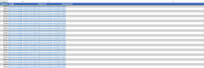

Posted 22 December 2023, 4:45 pm EST - Updated 22 December 2023, 4:50 pm EST
Hi, thanks for the update, I have tested the solution. It works in some cases, but not in others. For example itr works when you are moving down in the cells, but when you move up it does not work as shown in the attached image.
The reason is that **processMouseEnter **is fired as soon as the mouse enters the cell, however the tooltip is not shown until the mouse is over the hyperlink, even though the mouse is already inside the cell.

The mentioned issue has been fixed in the latest version of SpreadJS V17.0.3. Now, the devs have added the class “gc-spread-hyperlink-celltype-tooltip” to the hyperlink celltype tooltip element to locate and customize.
Also, the devs have suggested to use the processMouseMove instead of the processMouseEnter event, here is the updated code:
processMouseMove(hitInfo) { // Set linkToolTip const { sheet, row, col } = hitInfo; let value = sheet.getValue(row, col); if (value) { const httpLink = this.extractLink(value); if (httpLink) { super.linkToolTip(httpLink[1]); } } // Invoke processMouseMove method of super class super.processMouseMove.call(this, hitInfo); if (hitInfo.isReservedLocation) { // Get the Tooltip Element var element = spreadHostEl.querySelector(".gc-spread-hyperlink-celltype-tooltip"); if (element) { var rightPosition = element.offsetLeft + element.offsetWidth; let spreadHostElRightPos = spreadHostEl.offsetLeft + spreadHostEl.offsetWidth; if (rightPosition > spreadHostElRightPos) { // Adjust the Left and Right of the Tooltip Element element.style.left = (element.offsetLeft - (rightPosition - spreadHostElRightPos)) + "px"; } } } }
You may refer to the following sample here at: https://jscodemine.grapecity.com/share/qk6JnHezXE2BxrP3yT3gnw/?IsEmbed=false&Theme=Unset&PreviewDirection=0&IsEditorShow=true&IsExplorerShow=true&IsPreviewShow=true&IsConsoleShow=true&IsRunBTNShow=false&IsResetBTNShow=false&IsOpenInCodemineBTNShow=false&PanelWidth=20&PanelWidth=50&PanelWidth=30&defaultOpen={"OpenedFileName"%3A["%2Fsrc%2Fapp.js"]%2C"ActiveFile"%3A"%2Fsrc%2Fapp.js"}
