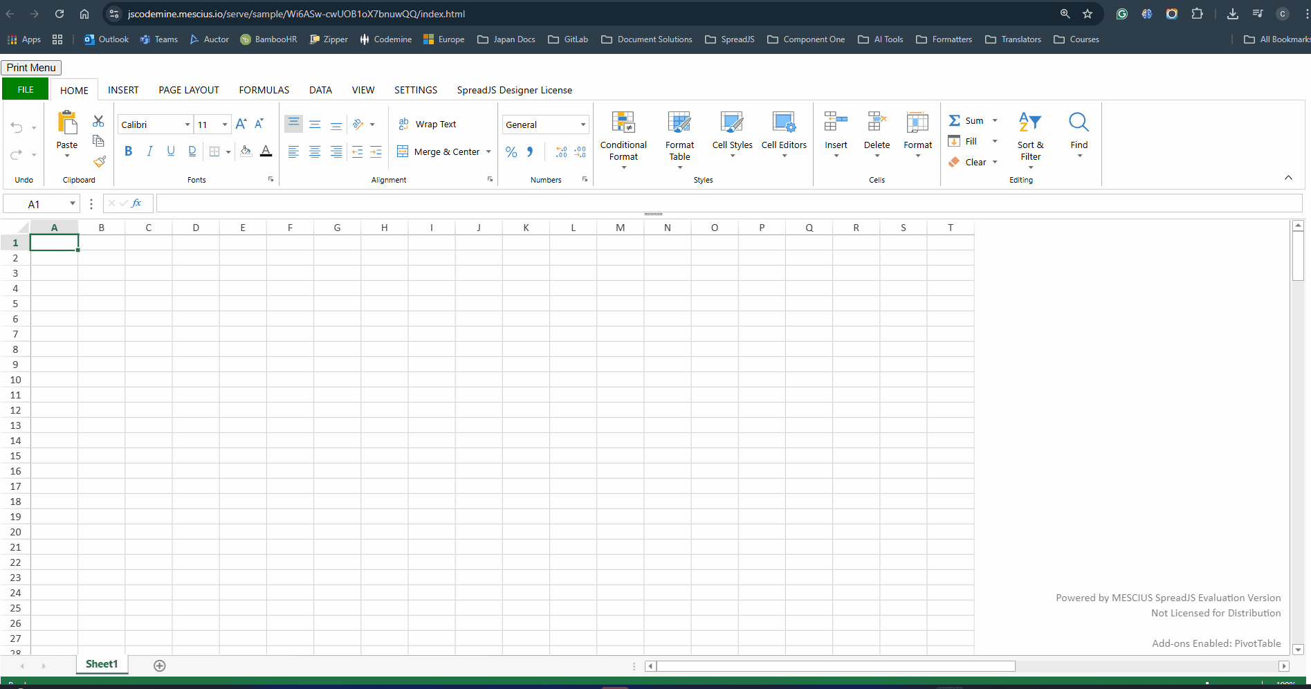

    You can further refer to the attached code sample that uses the above code snippet and opens the Print Menu using an external button (see below).
    Please note that the command manager is specific to SpreadJS and is not meant to alter the designer-specific operations. Therefore, the command manager’s execute method will not trigger the Print Menu open action.
    Sample: https://jscodemine.mescius.io/share/7wPiO0lM5U23fouQlOiZtA/?defaultOpen={"OpenedFileName"%3A["%2Findex.html"%2C"%2Fapp.js"]%2C"ActiveFile"%3A"%2Fapp.js"}
    Gif:
