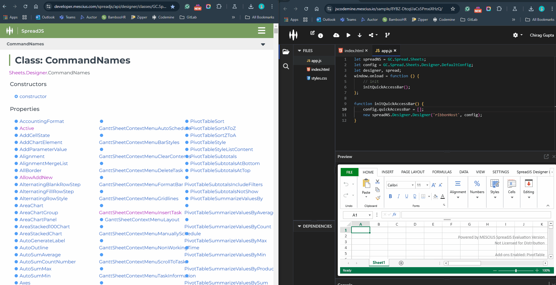

    The Quick Access Bar is part of the SpreadJS Designer. Still, there are no quick access options in the default designer configuration, due to which there are no options related to the quick access bar in the Designer API. However, quickAccessBar is an array of command names, when initialized will perform the respective action.
    Please refer to the code snippet below which illustrates the above said-
    config.quickAccessBar = ["commandName1", "commandName2", ...];
    designerInstance.setConfig(config);
    You can further refer to the attached sample that uses the above code snippet and adds the quick access bar to the SpreadJS Designer Component (see below).
    Quick Access Bar sample: https://jscodemine.mescius.io/share/3f9DdkA4ak6N1tr1iN0NOA/?defaultOpen={"OpenedFileName"%3A["%2Findex.html"%2C"%2Fapp.js"]%2C"ActiveFile"%3A"%2Fapp.js"}
    Refer to the attached GIF:
