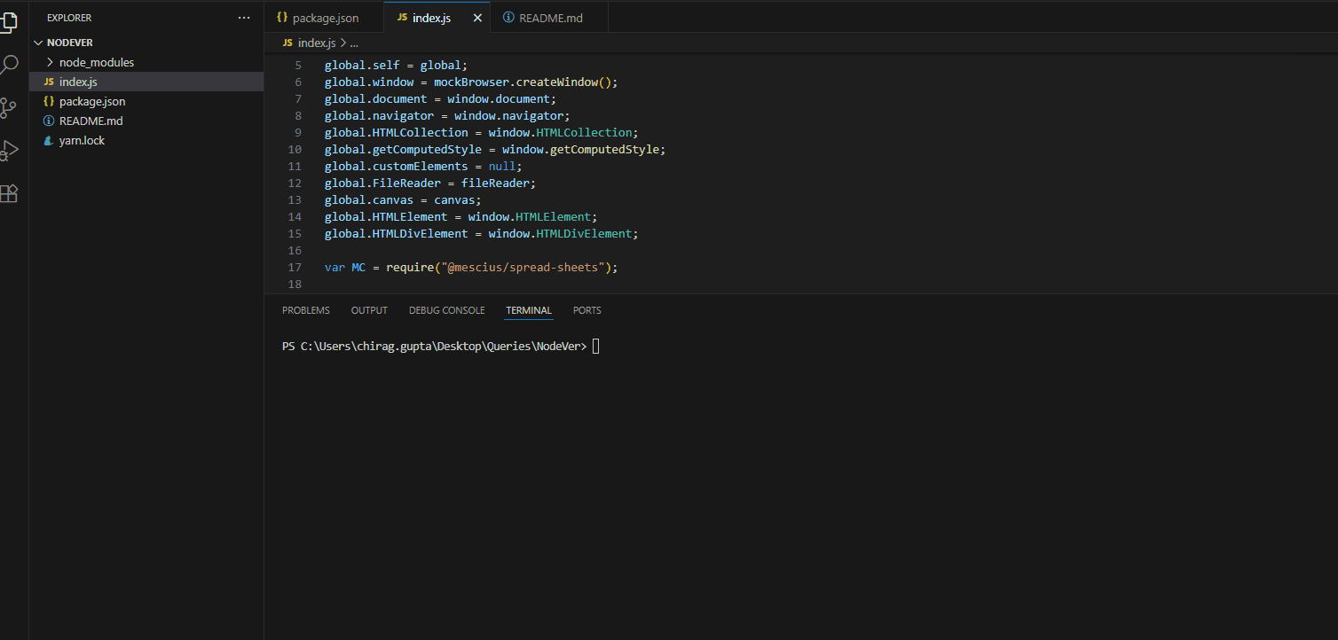

    We are not able to reproduce the issue you mentioned on our end using NodeJS Version 22.16.0. Please refer to the attached sample that works as expected and sets various variables to the global object without throwing any errors (see below).
    Could you please share a stripped-down sample application to investigate the issue further? You can also modify and share the attached sample to replicate the issue.
    Gif:
    Sample: NodeVer.zip

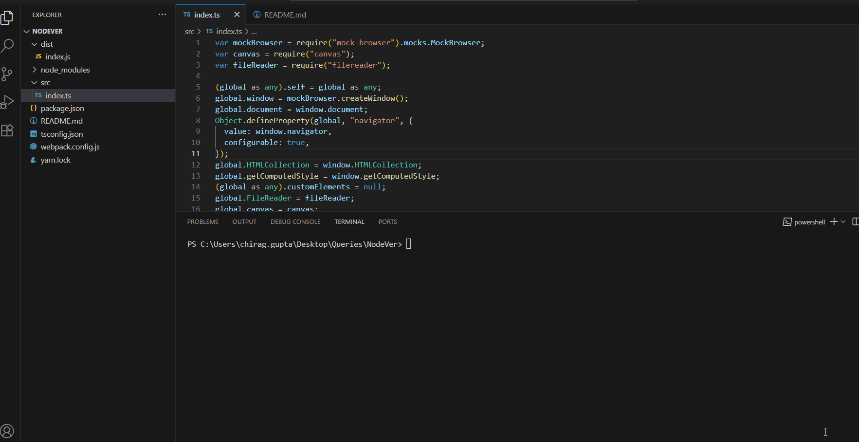

    To address this behavior, we recommend updating your code to use Object.defineProperty instead of directly assigning global.navigator. This approach safely bypasses the restriction and allows SpreadJS to function as expected in the simulated browser environment.
    Please refer to the updated code snippet:
    Object.defineProperty(global, 'navigator', {
      value: window.navigator,
      configurable: true,
    This technique is safe and commonly used when simulating browser-like environments in Node.js, and we have confirmed it works correctly with mock-browser and SpreadJS under Node.js v22.16.0.
    You can also refer to the attached code sample that demonstrates the above solution (see below).
    GIF:
    Sample: NodeVer.zip
    Please let us know if you encounter any further issues or require additional guidance.

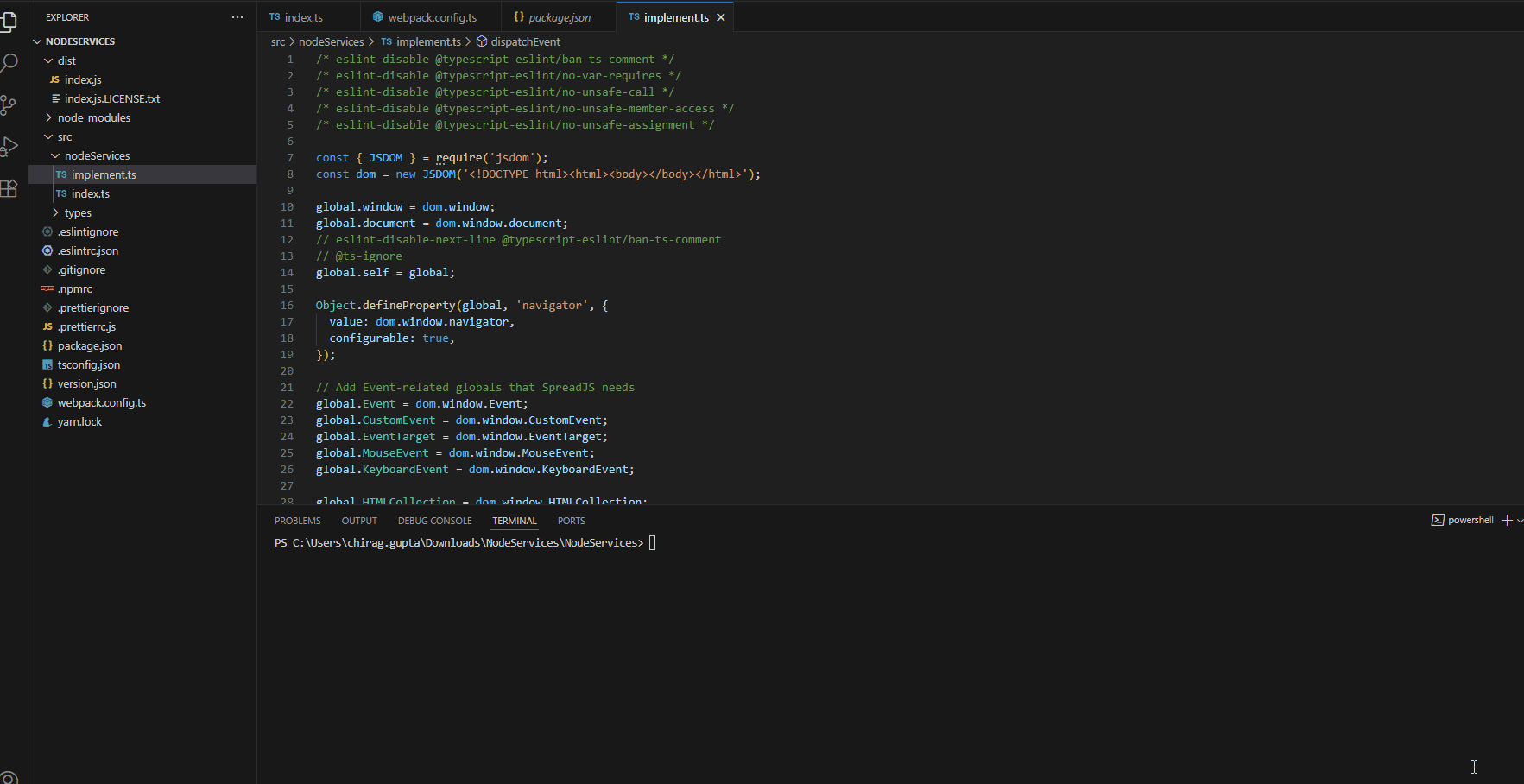

    We can replicate the behavior you mentioned on our end.
    The root cause of the issue is that certain DOM-dependent APIs within SpreadJS require a browser-like environment, especially for dispatching DOM events during culture setup. The mock-browser does not provide complete support for event handling and therefore fails when culture-related APIs such as CultureManager.culture(“jp”) are invoked.
    To resolve this, we recommend switching from mock-browser to jsdom. jsdom offers a more accurate simulation of the browser environment, including event dispatching support required by SpreadJS internally.
    Please refer to the updated code sample for your reference (see below).
    GIF:
    Please feel free to reach out if you encounter any further issues or require additional assistance.
