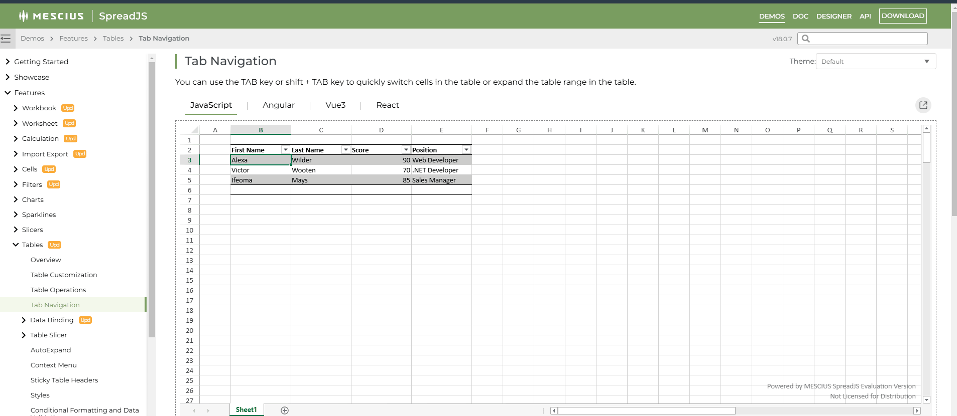

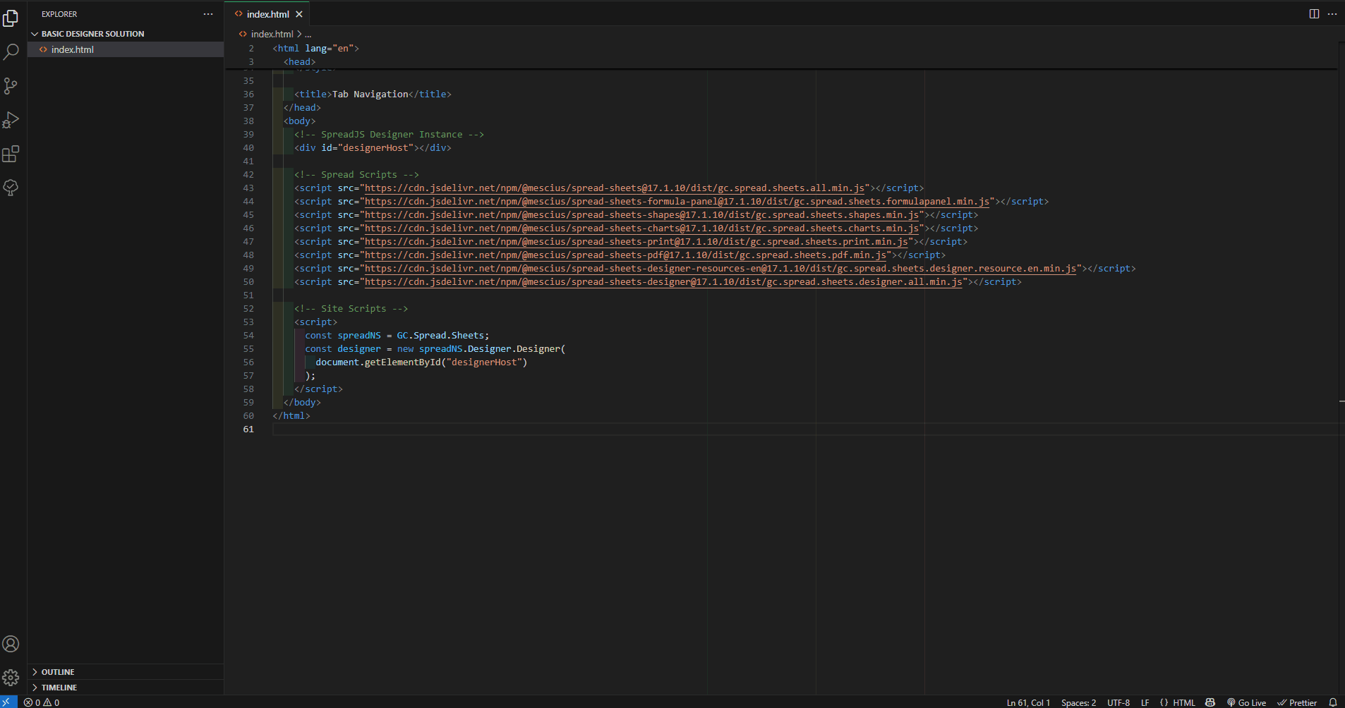

    We are not able to replicate the issue you mentioned on our end. Please refer to the attached sample and screenshots illustrating the same (see below).
    Additionally, we also tried to replicate the issue on Tab Navigation https://developer.mescius.com/spreadjs/demos/features/tables/table-navigation/purejs Demo page, however, there is no lock up which infinitely calls the method - getActiveSelectedRangeIndex.

    Refer to the attached GIFs and sample.
    Sample: Sample.zip
    GIF1:
    GIF2:
    Disclaimer: Please note that in the second screenshot, the Tab key first navigates to different other components than Grid.
