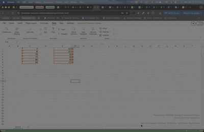

    This is expected, as Excel does not support SpreadJS-specific features like highlight-style icons and dogears, so they will not persist after saving to Excel or after importing the file back into SpreadJS. However, these features are preserved when using SpreadJS formats such as .sjs or .ssjson. Please refer to the attached GIF and the Designer link: https://developer.mescius.com/spreadjs/designer/index.html
    GIF:
    So, if you want these features to persist after saving and loading, please use the sjs or ssjson formats.
