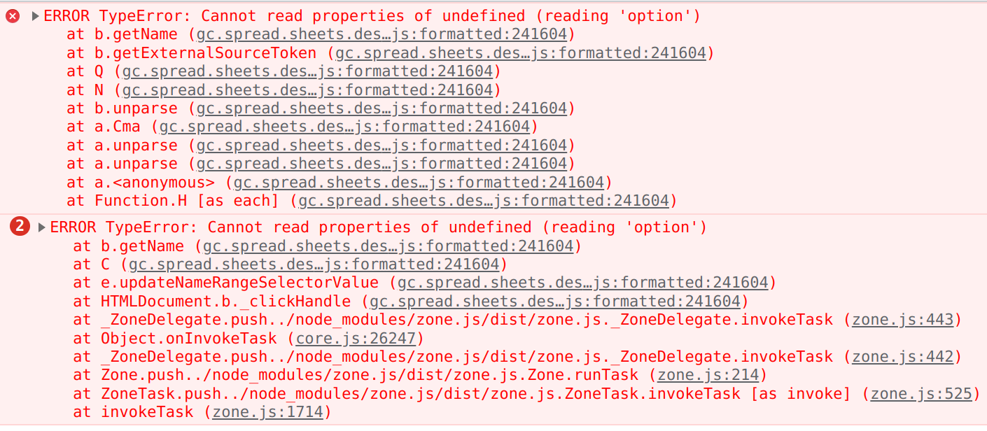

    When trying to import a .xlsx spreadsheet that contains external links, the following error occurs:
    core.js:4002 ERROR TypeError: Cannot read properties of undefined (reading 'option')
        at b.getName (gc.spread.sheets.designer.all.min.js:formatted:241604)
        at b.getExternalSourceToken (gc.spread.sheets.designer.all.min.js:formatted:241604)
        at Q (gc.spread.sheets.designer.all.min.js:formatted:241604)
        at N (gc.spread.sheets.designer.all.min.js:formatted:241604)
        at b.unparse (gc.spread.sheets.designer.all.min.js:formatted:241604)
        at a.Cma (gc.spread.sheets.designer.all.min.js:formatted:241604)
        at a.unparse (gc.spread.sheets.designer.all.min.js:formatted:241604)
        at a.<anonymous> (gc.spread.sheets.designer.all.min.js:formatted:241604)
        at Function.H [as each] (gc.spread.sheets.designer.all.min.js:formatted:241604)

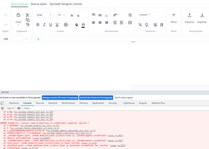

    There is no error when importing, but when I click on any element on the screen, the error below occurs and all the tabs disappear.
    See in the image below:
