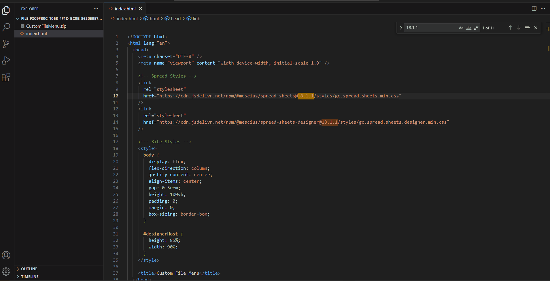

  • Posted 3 June 2025, 2:13 am EST - Updated 3 June 2025, 2:18 am EST
    We were unable to reproduce the issue you mentioned. The getState override is working as expected on our end. Please refer to the attached sample project and the screenshot below for reference.
    To help us investigate further, could you please share a sample project where the issue is reproducible? Alternatively, you may modify the attached sample to replicate the issue you mentioned.
    Gif:
    Sample: CustomFileMenu.zip
