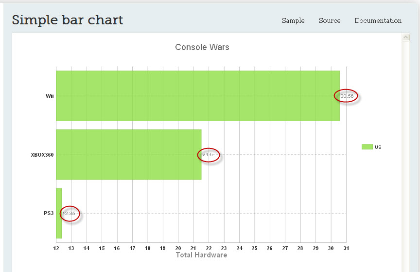

    I am using C1StudioAspWijmo_2012v3 ,everything is working fine except barchart with decimal values. It is not working even in the barchart examples came along with product.
    I am using the product in German (Germany) culture.
    I have attached the screenshots of the barchart and code.

  • Posted 10 September 2017, 11:53 am EST
    Shalini,
    I tested this issue at my end and the decimal values render correctly for me in a bar chart. Since you are working with German locale, I changed the regional settings on my machine to German (Germany) culture; however the decimal values were still correct.
    Can you please provide me the steps on how can I reproduce this issue? I have attached a screenshot of the chart as it looked on my machine. Also I am currently running the latest build 3.5.20131.103 of Wijmo. You can download it from the following link if you do not have this build currently installed:
    prerelease.componentone.com/dotnet30/c1webwijmo.webforms/2013-t1/C1WebWijmo.Webforms_3.5.20131.103.zip
    Sankalp
    Hi Sankalp,
    Thank you for your Reply.
    I have installed Componentone Studio for ASP.NET Wijmo and created a Barchart in Web application in .NET, Initiallay it was working Fine but then when Decimal values like 12.35 are passed ,barchart is taking it as two values ‘12’ and ‘35’. I thought I am doing some mistake so i checked with ASP.NET WebForms Samples( came with ComponentOne installation) in my local machine, even here when i run the sample application same thing is happening.
    Shalini
    Shalini,
    Is this issue specific to the machine which you are using at the moment? When I tested this issue, I changed my machine locale to German but the issue was not reproducible. Are there any specific steps which are required to replicate this issue? As a test can you please try running the same sample on any other machine with a different culture? Any additional information provided to narrow down the issue would be appreciated.
    Sankalp
