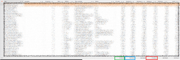

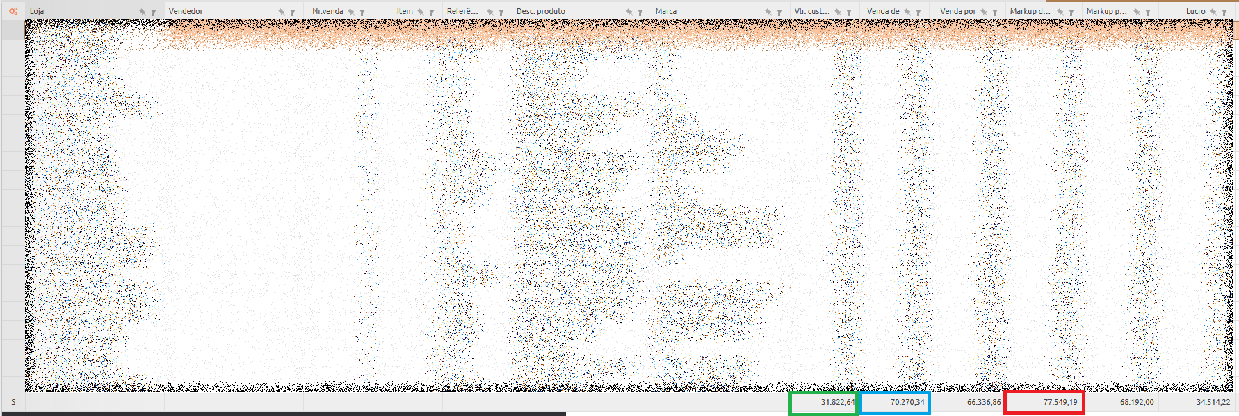

    According to the attached image, I need to calculate the total that is in red, making an account with the values that are in green and blue. Red = ((Blue / Green * 100) - 100).
    How to proceed in vue.js?

  • Posted 18 May 2021, 9:28 am EST
    Good morning, unfortunately this is not my case. I need to calculate the final result, in the footer. As per the picture.
  • Posted 19 May 2021, 2:20 pm EST
    To achieve the required functionality you may handle initialized event as well as cellEditEnded event and inside handler you may get columnFooter cell’s data using getCellData,pPerform calculation and then assign the calculated value to the columnFooter cell using setCellData.
