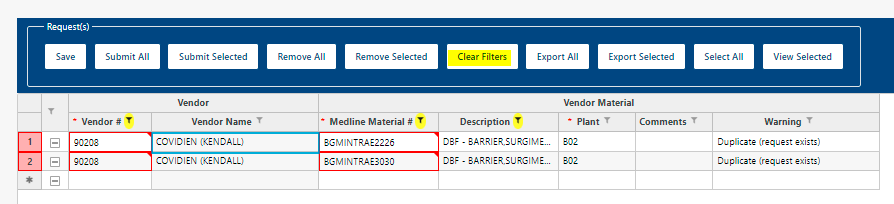

    We have JS based custom wijmo grid (wj-flexgrid). we have enabled FlexGridFilter for all the columns of that grid.
    Now, we want to have the ability to clear all applied filters once, instead of checking which filter is applied on which column and clearing those manually.
    To achieve this, we have added one button on the menu, and on click of that button I’m calling one JS function to clear all applied filters.
