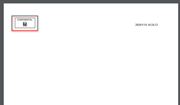

I want to add an image to the left of the header
Please refer to the attached file
https://jsfiddle.net/4o8hq12p/16/
Please help me

You may use the drawImage method of the PdfDocument class to draw an image.
https://www.grapecity.com/wijmo/api/classes/wijmo_pdf.pdfdocument.html#drawimage
Please refer to the sample attached for reference.
