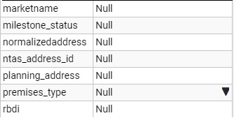

    I need to have the dropdown symbol at the end of the specific row in my flexgrid. My grid is having 2 columns with mixed data-type. The requirement is let the user know which row is required, disabled, dropdown etc.
    I achieved all these through row.cssClass except the dropdown one. Here is the existing code.

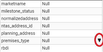

    So, in my “field-dropdown-type” I should have the style to show the dropdown symbol for that row. Please refer the attached image. In the attached image for the “Premises_type” row I need to add a kind of symbol looks like in the image. So the user will know that the row is dropdown selectable value.
