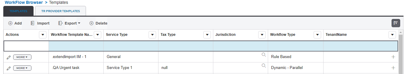

    i need to do operation like add, delete and update functionalities in grid.
  • Posted 25 July 2021, 10:21 pm EST - Updated 3 October 2022, 1:04 pm EST

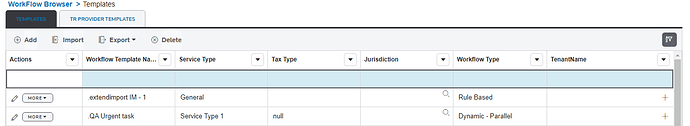

    when i click add button added row but columns data not added automatically.
    see here i have new row with empty data,
    1)in actions columns need to show more botton
    2)jurisdiction and tenetname columns need to show with search and plus icon when i click add row.
  • Posted 26 July 2021, 7:27 am EST
    We were not able to replicate the scenario based on the information provided. Can you clarify, how you have created these custom cells (whether they are created using itemFormatter or through using cell template)? Kindly provide a sample or make changes in the below sample depicting the issue.
    However, to render the custom cell content in a newly added row, you may make use of the cell template property of the FlexGrid column.
    Please refer to the sample below:
    https://stackblitz.com/edit/angular-xkcztq

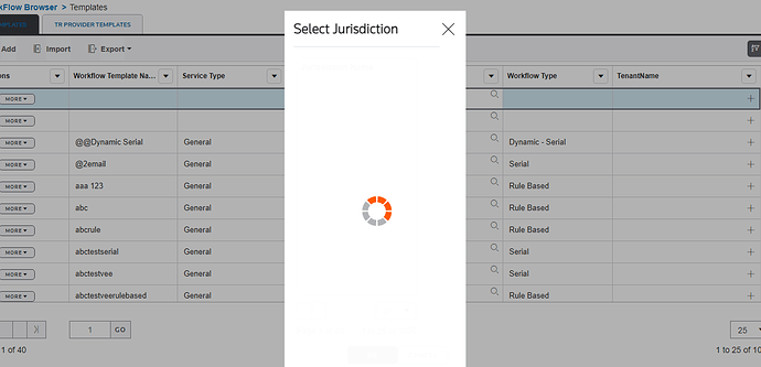

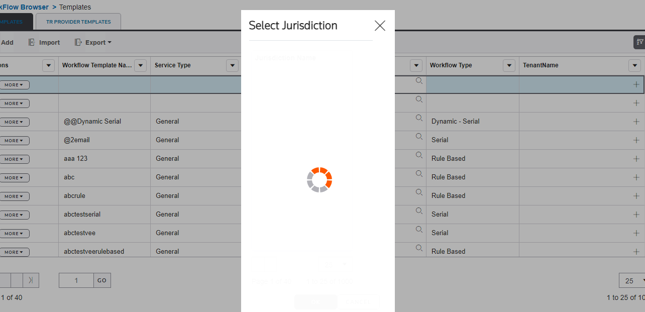

    when i click (newrow) row inside +symbol popup will open,but here popup showing on bottom while grid scroll moving down popup appear .
  • Posted 30 July 2021, 6:41 am EST
    when i moving down using scrollbar popup is showing,other wise popu is bottom of the grid
  • Posted 30 July 2021, 6:42 am EST
    after clicked on + icon popup not appear then am doing scroll down then popup is appear

  • Posted 2 August 2021, 4:00 am EST
    Can you share which modal popup are you using? Is it of wijmo or some other library? Also, can you share the OpenJurisdictionModal method’s implementation?
  • Posted 2 August 2021, 8:01 am EST
    It is ngb modal service
  • Posted 2 August 2021, 11:27 pm EST
    openJurisdictionModal() {
    if(this.flexGrid.selectedItems.length>0){
    let value = this.flexGrid.selectedItems[0].Jurisdiction;
    let data = [{ “getItem”: value }];
    this.workflowService.sendMessage(data)
    }else{
    let value=null;
    const options = { windowClass: 'modal-scroll textFieldJurisdiction', ariaLabelledBy: 'modal-scrollable-title' };
    const modalRef: NgbModalRef = this.modalService.open(JurisdictionComponent, options);
    modalRef.componentInstance.openModal = true;
    modalRef.result.then((result) => {
      this.workflowService.getMessage().subscribe(res => {
        this.JurisdictionSelectedItem = res[0].jurisdictionData;
        this.isSelectedJurisdiction = res[0].selected;
      if (this.isSelectedJurisdiction) {
        let row = this.flexGrid.selection.row;
        let col = this.flexGrid.columns.getColumn("Jurisdiction").index;
        this.flexGrid.setCellData(row, col, this.JurisdictionSelectedItem);
  • Posted 2 August 2021, 11:28 pm EST
    public modalService: NgbModal
    reusable component
  • Posted 3 August 2021, 3:15 am EST
    Hi bemes9226,
    It seems that the issue is in ngb-modal. Unfortunately, it is not one of our components, so we cannot provide support for it. If possible, can you try using Wijmo’s Popup instead of the bootstrap modal and if you run into any issues with it, we will help you out.
